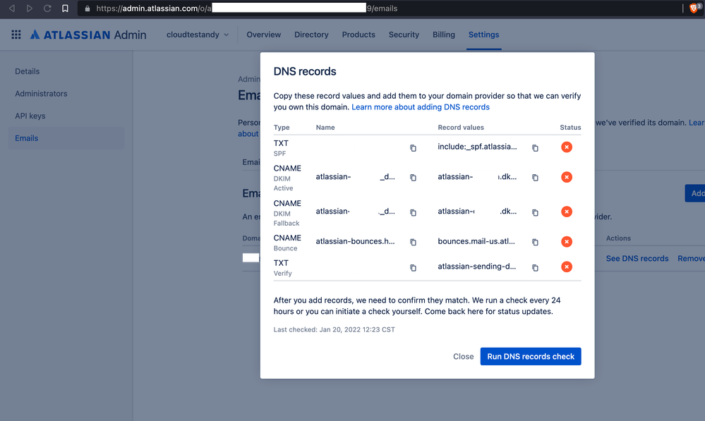

You can force a recheck by going to admin.atlassian.com > select the site/organization in question > Settings > Emails > email domains > See DNS records.

You could also try to remove those records, but note if you do this and then try to add that domain back to this page, the record values are going to change and in turn you then need to update the DNS TXT records on your site to match what we have on this page.  It usually takes some time after a DNS record like this is updated before that change is propagated to other DNS servers, which is part of the reason we only check this by default on a 24 hour interval.

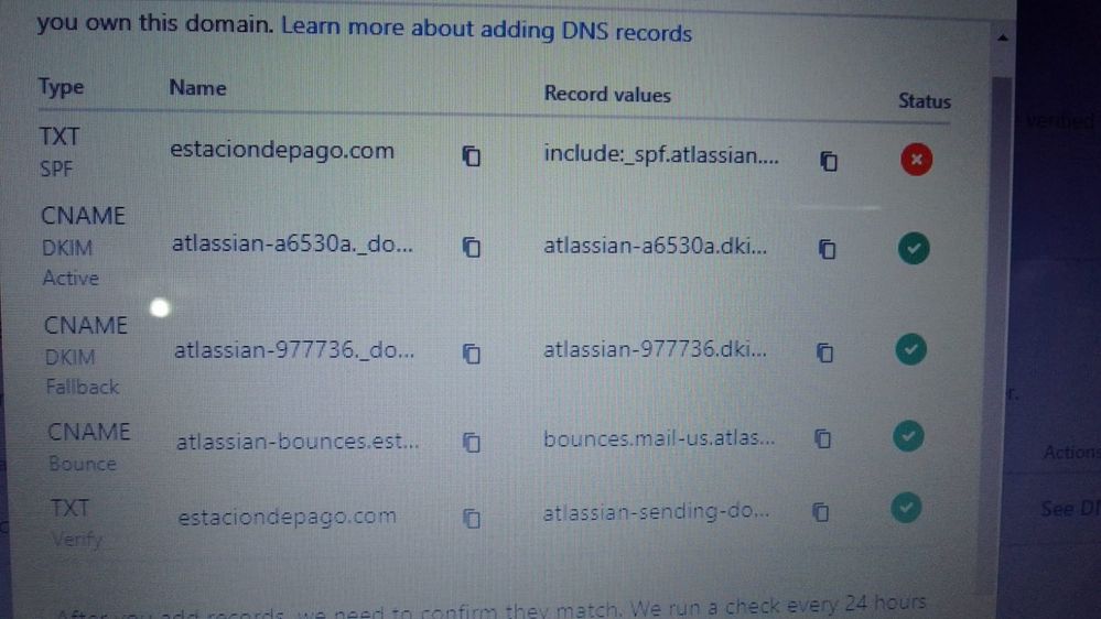

LUIS ROLDAN
May 29, 2022
Hi guys,
I am facing similar problem. The difference is tha 4 of 5 DNS records values were verified by Atlassian server.
Only TXT (SFP) value is missing, the remaining 4 were verified. I retried to entry, reboot, and run the DNS check several times with the same result.
This is the value of the record.
include:_spf.atlassian.net
Does anyone has a route couse to solve this?

On the above issue (specifically the TXT / SPF record), there's further documentation, but, you need to either:
  • Integrate the record with your existing SPF record (which will start with e.g. `v=spf1` OR
  • Create a new TXT record, as below
v=spf1 include:_spf.atlassian.net -all
 If you already have one of these, just make sure the `include:_spf.atlassian.net` is in the middle of it (before the `-all`)
