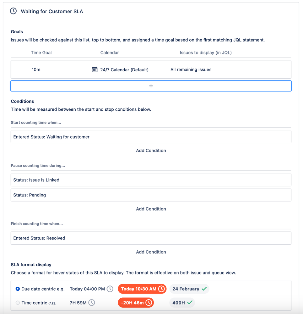

There is SLA automation that we use for Reporter.
Attached are images.
I want this; If the reporter comments within 48 hours, the ticket status will be "on hold" automatically.
Is it possible?
Will this happen only on tickets that we've received as "Waiting for Customer"?
If there is an automatic "on hold" status, the SLA will stop for 48 hours.

I want this as the 48 hour SLA is a process for us.
When the customer returns, we may forget to set it to "on hold" status. (There may be workload)
That's why I want the "Waiting for Customer" status to be automatically "on hold" status if the customer returns (comment) within 48 hours.

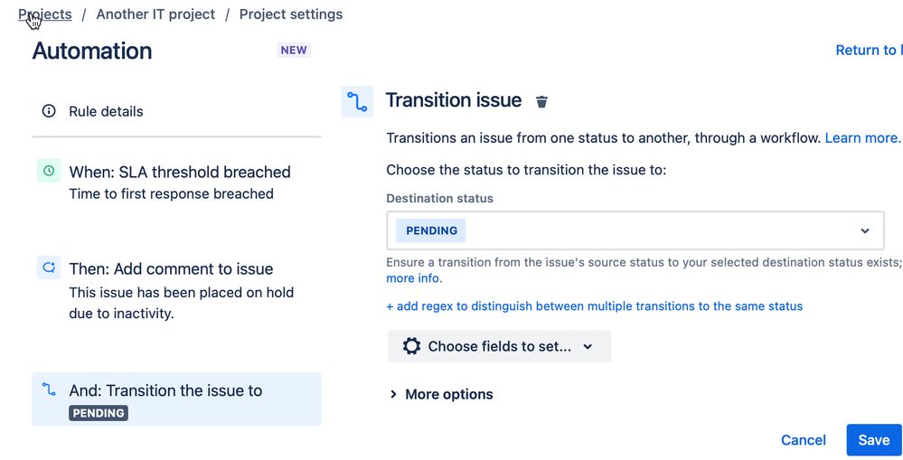

Jack Brickey
January 12, 2023
ok so let me reset and capture what you want...
If you want to transition an issue to "On Hold" if it has been in Waiting for customer for more than 48 hours then your rule should look like this...
Please note in the above example you will want to reference your actual threshold and usually on hold status rather than pending. I did not have your SLA for and on hold status to use in this example.

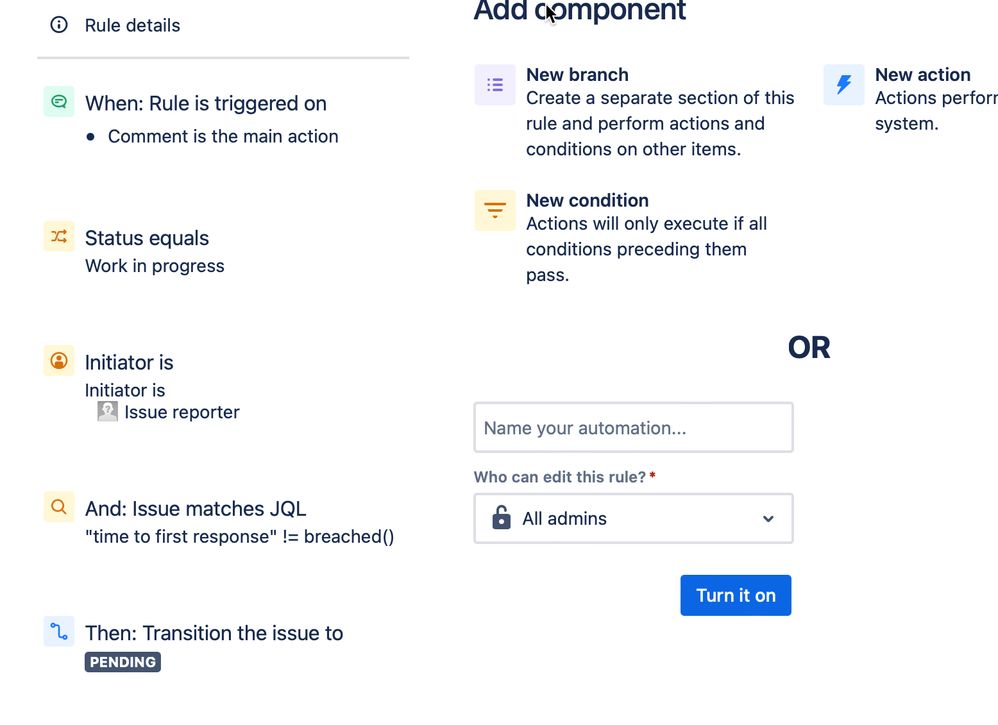

If you want to transition an issue to "On Hold" that is in the Waiting for Customer status if the customer replies within 48h of entering Waiting for Customer then try the following rule structure...
Please note the following in the above example:
  • The trigger is on any comment where it is the main action
  • the Initiator condition restricts to Reporter (customer)
  • the JQL condition checks if the SLA has breached which allows the rule to exit if a customer comments outside of the other conditions, e.g. not in WFC status or SLA is no running. You need to change the SLA name here.
  • The action should change to On Hold
Please let me know if this is what you're looking for or close. I would suggest creating the rules and testing them to achieve your exact requirements.

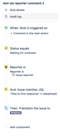

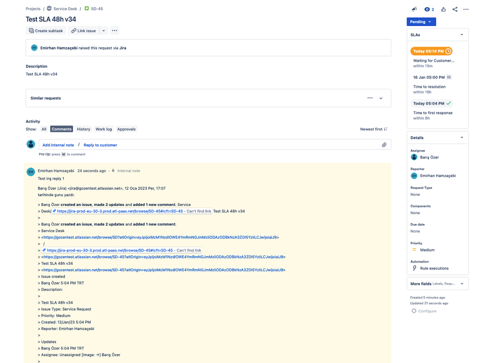

Barış Özer
January 12, 2023
Hi @Jack Brickey
Hello,
I made it like the 2nd screenshot. And it was successful.
I couldn't do it like in the 1st screenshot. So I tried the 2nd screenshot.
I want this and can you give exact answer?
This rule should work only when there is a Waiting for Customer status.
When "reporter" comments on a different ticket, the status is not "on hold" right?
And, when the "reporter" comments, there is a lot of unnecessary text as in the screenshot. Why is that?

Jack Brickey
January 12, 2023
The rule that I provided will only transition an issue to "On hold" if all of the conditions (status = Waiting for customer AND the comment is made by the Reporter AND the SLA has not yet breached). You asked...
"When "reporter" comments on a different ticket, the status is not "on hold" right?"
Again, if the reporter comments on any ticket the rule will be triggered but the action will only be executed if all 3 conditions are met.
Regarding the text in the comment I really can't say where that's coming from. Maybe you've got some other automations or something I just don't know. However I will note that the yellow comment is an internal comment. Are you testing this where you are the reporter?
