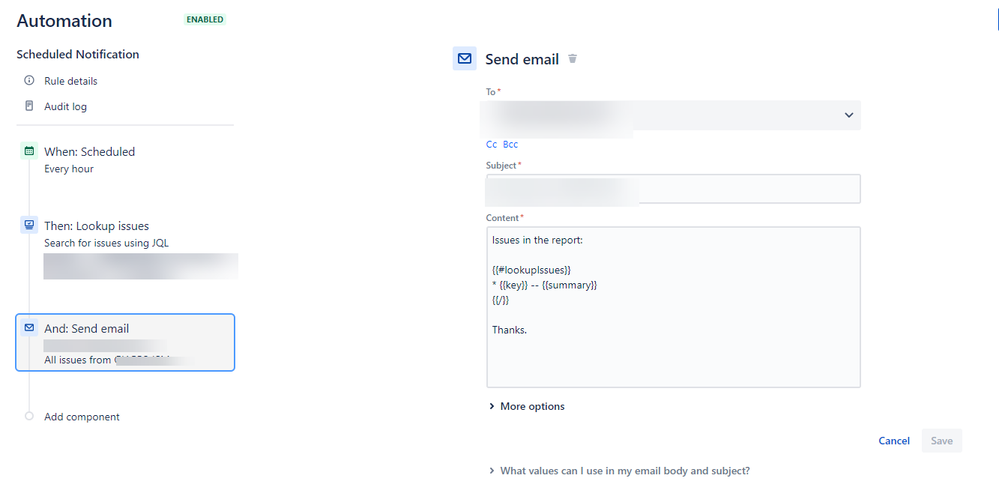

Here you go...how to display the JQL result in your email body via the automation rule -
For the email body context - you will need to use the "lookupissues" function referenced smart value (https://support.atlassian.com/cloud-automation/docs/jira-automation-actions/#Automationactions-Lookupissues)
Example -
Issues in the report:
{{#lookupIssues}}
* {{key}} -- {{summary}}
Thanks.
This will generate the following email example -
Here is a sample for the automation rule -
Lastly, there is a limitation of 100 issues per JQL search as documented in the reference link listed above.
Hope this helps.

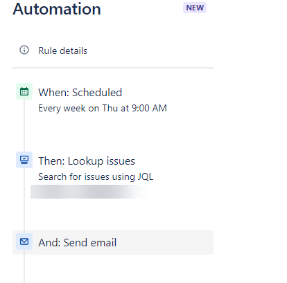

One only thing now is, currently there is 8 tickets showing which is correct but I am getting 8 emails notifications with the same report.
How would I only get it once per schedule?

Are you saying you are getting the same report email multiple times?  Are they all coming at the same time into your email client?
Best, Joseph
Danielle David
November 20, 2022
Hi @Joseph Chung Yin
Yes same time.
Regards
Joseph Chung Yin
November 20, 2022
Can you share your automation rule with me?  Question - Is the rule only for a specific project or it is a rule where you set it up as a global rule (where it is applied for multiple projects?).
Best, Joseph

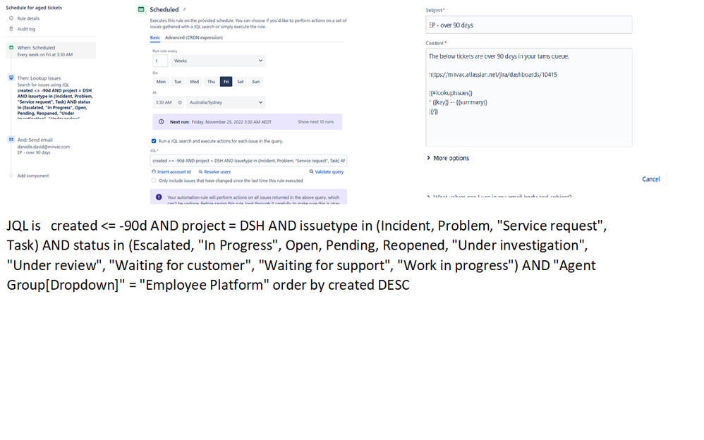

Danielle David
November 20, 2022

Sorry for my late response.  Thanks for your information on your automation rule.  The rule looks fine, and I don't know why you are receiving the same custom email (defined) in your send email action multiple times and at the same time.
At this moment, I would recommend you to contact Atlassian Support (https://support.atlassian.com) for further assistance because they will be able to access the system logs on their end to determine the cause possibly.
Sorry,
Best, Joseph
