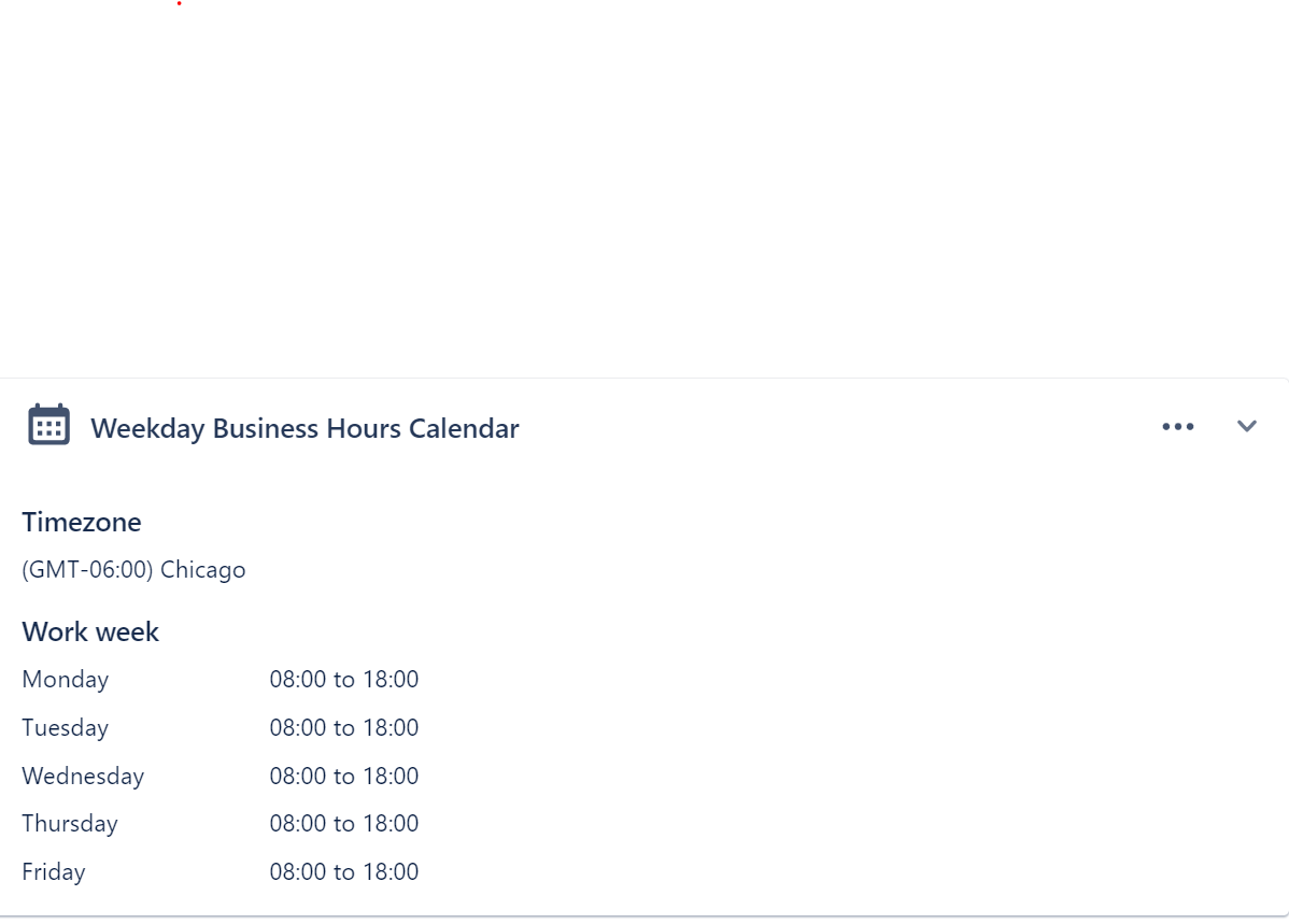

We have different SLA's based on times of day. I have pasted the SLA calendars and SLA's below.

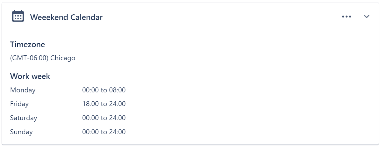

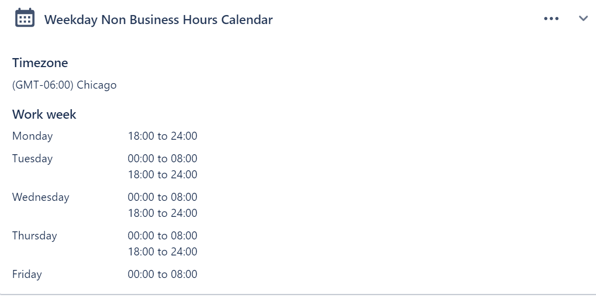

  • Calendars: Weekday Business Hours, Weekday Non-Business Hours, Weekends
Weekday Biz Hours Calendar.PNGWeekday Non Buinsess Hours.PNGWeekend Calendar.PNG

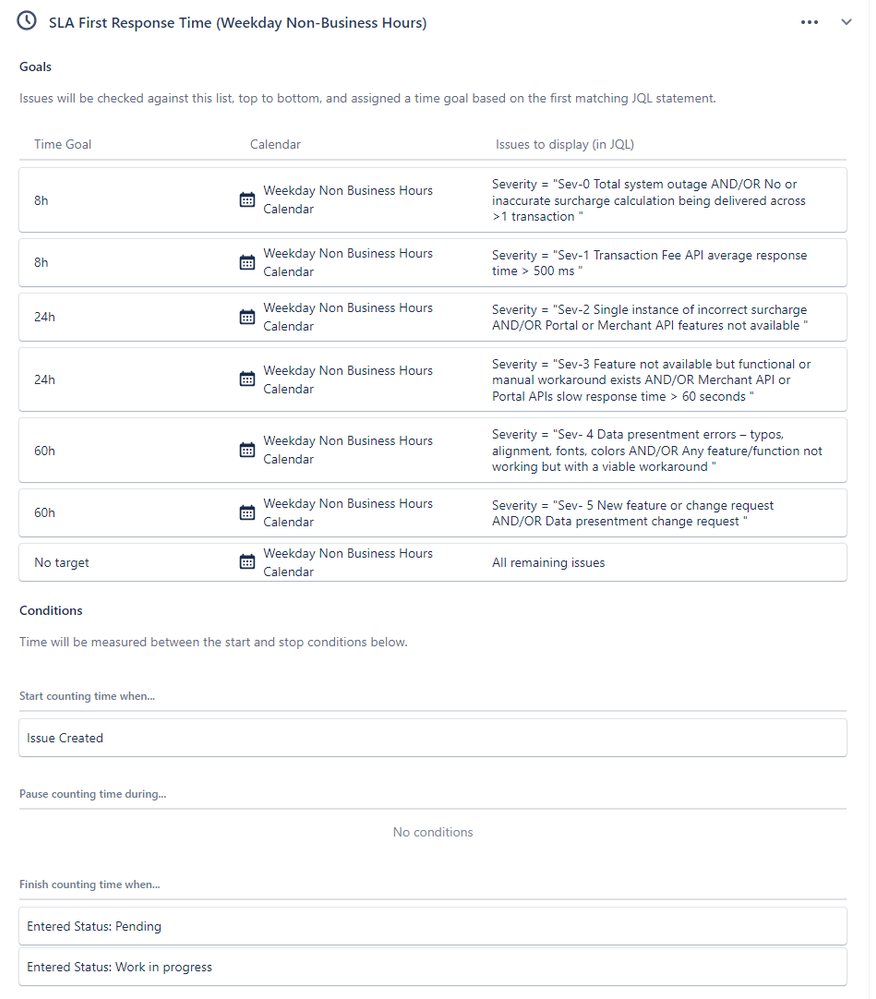

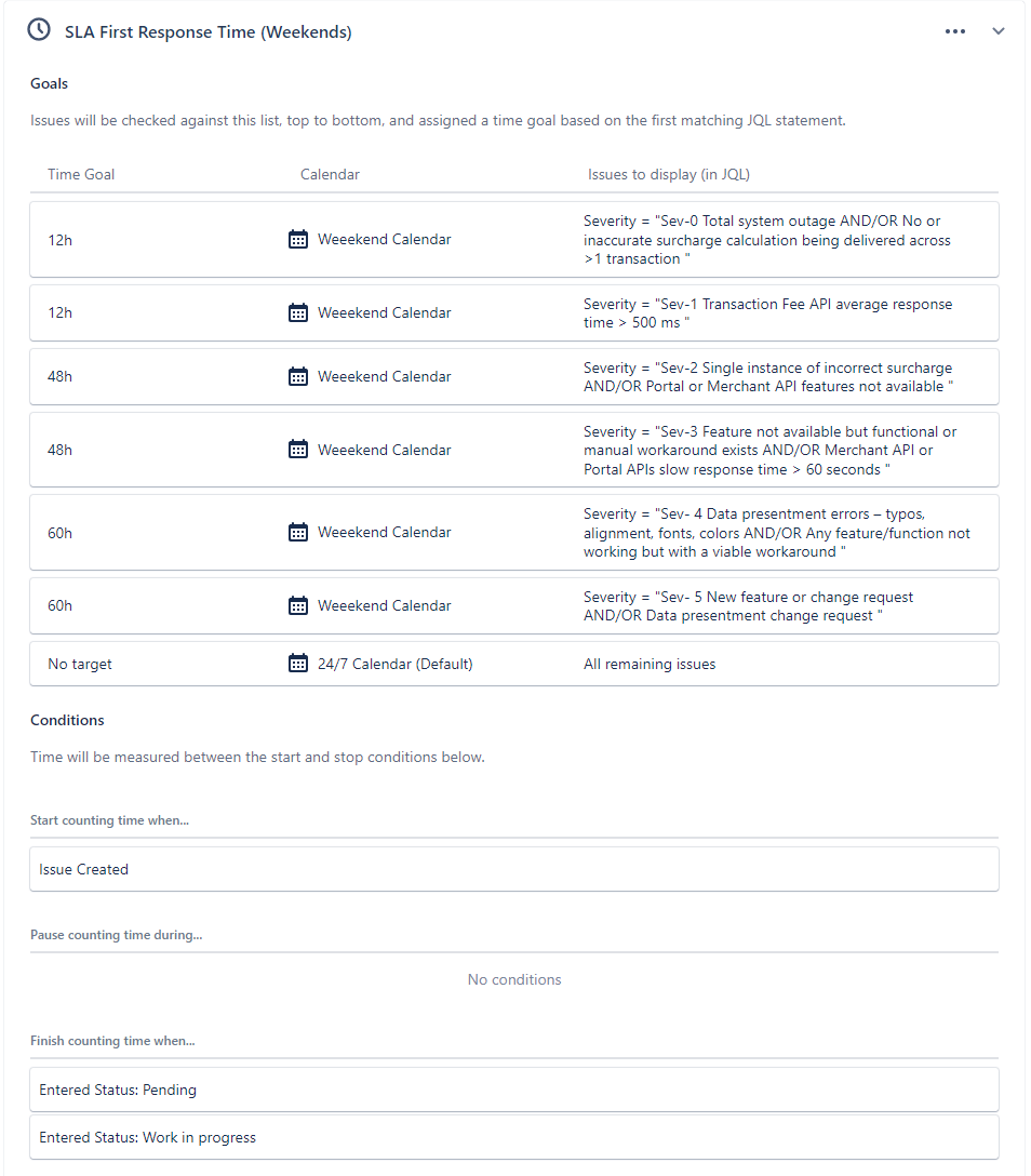

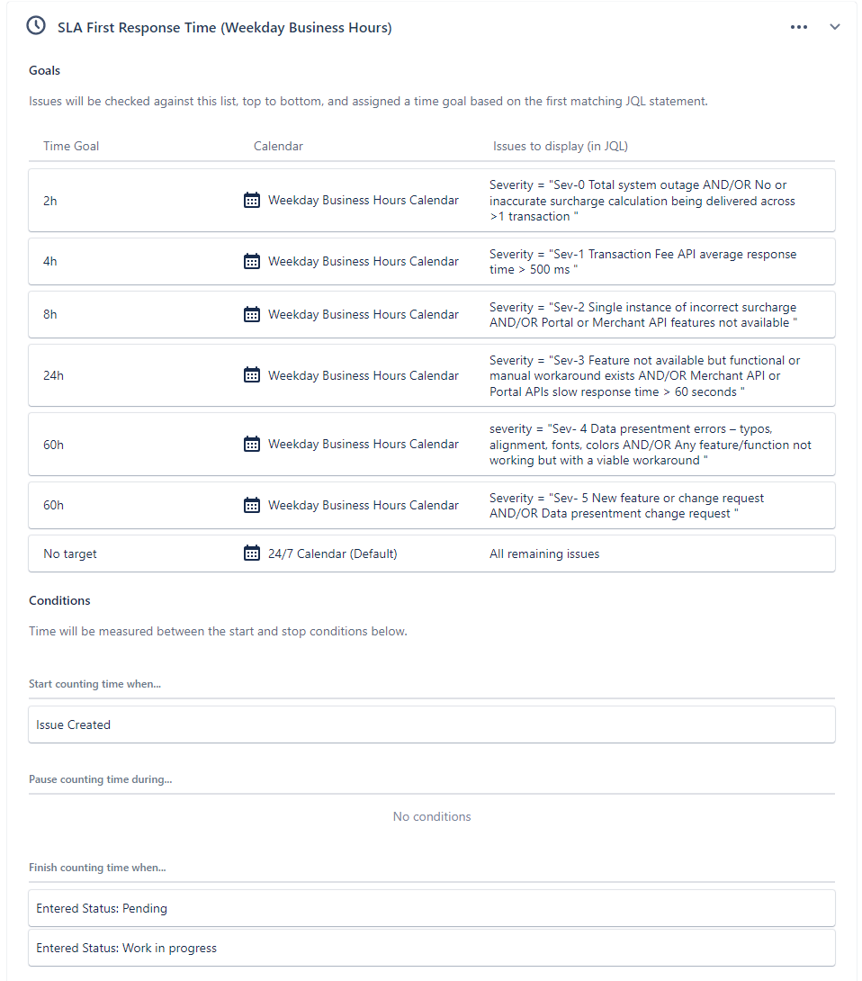

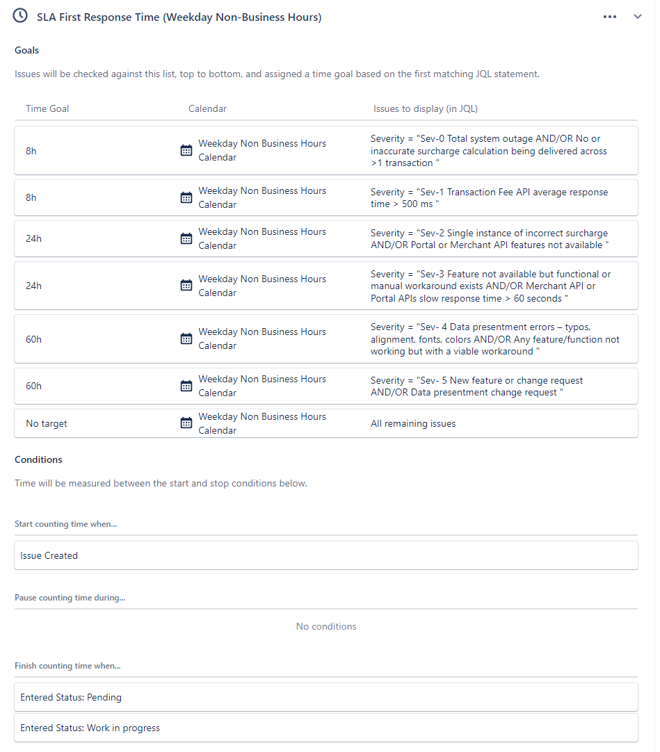

SLA's:--Once a severity has been associated with a ticket, these are meant to track time from when an issue is created to when the status is assigned to pending or work in progress, according to the different calendars.

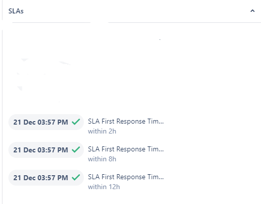

The problem I am having is when I am pulling reporting or looking at SLA's in the side window of the ticket field, I am getting the same performance across all SLA's, which doesn't make sense, given the ticket coming in at 1 time should only trigger one SLA.
For example, see the info on the ticket below.
For the below ticket, you can see all 3 SLA's have been checked off while the ticket was created at 03:17pm, aka during the Weekday Business Hours Calendar.
Ticket Example:
Created December 21, 2021, 3:17 PM
I would love any insight as to why all of the SLA's are being triggered when tickets are coming on under different schedules? I feel like this is the source of the problem and my set up might not be correct.

Hi @Bharath Sithian
First of all, you have all the queries the same in all the SLAs which matches the issue against the corresponding query.
Technically the clock will be running when you have all the SLAs in place.
The time will reduce only when it is inside the calendar hours.
Now the report meaning is that for an issue that you are showing all the SLA's are met within the time frame and it doesn't matter if it is outside of calendar hours since the clock will be paused for outside working hours. The time will only reduce in case it is within the calendar hours.
So basically what you are seeing is correct issue data.

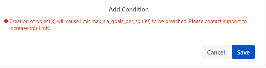

Bharath Sithian
January 3, 2022
i added the goals in 1 SLA like the following, is that what you meant? I also got the following error as well.
Please let me know if I'm doing this correctly or how my approach is incorrect!
@Pramodh M if you can provide a sample JQL language it would be really helpful. I'm not sure how I would handle referencing different calendars, severities, and time goal.
Pramodh M
January 4, 2022
Hi @Bharath Sithian
You need to create support ticket in order to have more goals,
Please follow the link below for adding the goals for a specific calendar
https://community.atlassian.com/t5/Jira-Service-Management/SLA-based-on-different-calenders/qaq-p/603799
