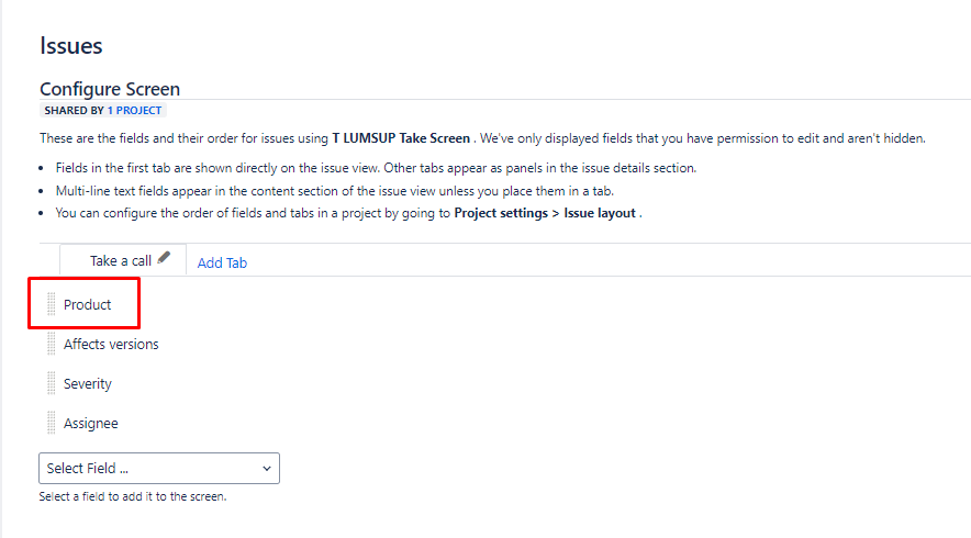

This field is also inclued in the project screen and in a transitions screen.

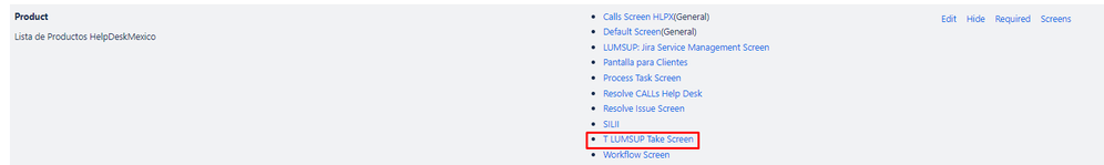

I tried to check with all aboved and everything look okay. Anyway I attached some screenshots to show you so maybe you can help us.
The image below is from the transition screen.
The image below is from the field configuration it is inclued not only in the transition screen that is highligthed but also in the thrid screen from top that is the default scren in the project,

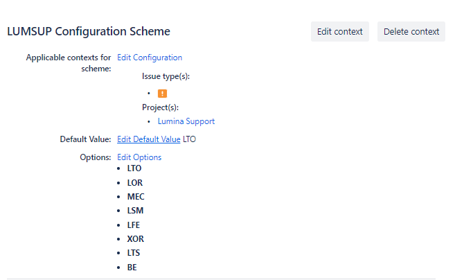

and the last screen that the user provided is the onw from the context configuration of the field

@Rosana Casillithe last screen shows that Product is available only for project Lumina Support and for one issuetype. In this case the transition has to be one for the workflow that corresponds to that issuetype in project Lumina Support, otherwise it won't be shown in the transition screen.

I need to check  with the user. But as far as I know, the issue type is associated to the workflow. But let me check with him.

Hola Adolfo!!! el flujo de trabajo está asociado al tipo de problema y la pantalla de transición está asociada a esa pantalla de flujo de trabajo

I am sure the screen is correct

Hi Nicolas!! yes now I am sure that it is associated to the correct project, correct issue and correct screen
