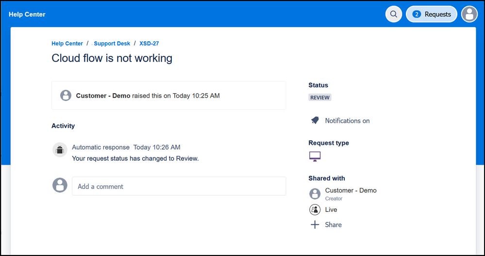

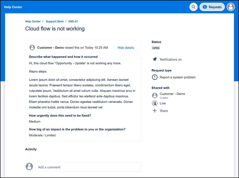

Hi, when i change the type of an incident to change, the customer is missing a lot of information on the portal side from the initial created request.
How can i solve this? What do i need to change?
View when entered by the customer in the Portal:
After the issue-type is changed to Change:

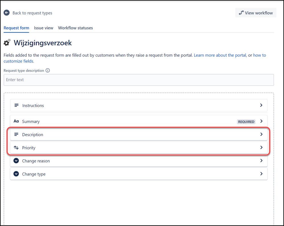

I think they are defined. I looked at the Description and Priority field for example:

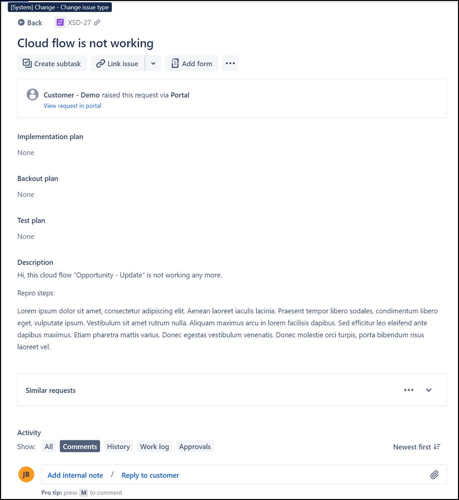

And in Jira Service Management (not the Portal) i have this view
Am i looking at the wrong place?
Thanks, Jos

Hey @Jos Blokdijk ,
please could you verify if the Request Type field is set on ticket JIRA side (not in the portal). For more information take a look to the following thread https://community.atlassian.com/t5/Jira-Service-Management/Description-field-on-My-Request-View-has-disappeared/qaq-p/1803655

@Fabio Racobaldo _Catworkx_ Thanks, that did the trick! The request type was NONE.
After changing this, the description is now visible on the Portal.
