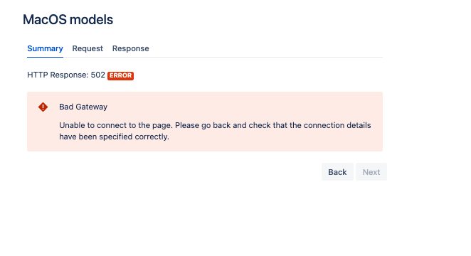

Do somebody tried to populate a data collection in new forms feature with Insight Rest Api ?
https://support.atlassian.com/jira-service-management-cloud/docs/create-edit-test-or-delete-data-connections-for-forms/
Seems to not support '? filters' when we try to connect.
Here my query :
https://api.atlassian.com/jsm/insight/workspace/confidential/v1/iql/objects?iql=ObjectType = "Supported MacOS Laptops" AND "status" = "offered"
and the result ( in Postman is working very well )  :

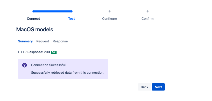

My query without filter :

@d.kirsching in the not too distant future you will be able to add insight fields directly to your forms, but in the meantime it looks like you have discovered a bug in the data connections in ProForma (i'm the product manager for ProForma/Forms).
We have added this bug to our backlog, but there is a workaround if you encode the url yourself e.g.
https://jsonplaceholder.typicode.com/users?page="1"
would become
https://jsonplaceholder.typicode.com/users?page=%221%22
and this appears to work.
You can use a webpage such as https://www.urlencoder.io/ to do the conversion yourself.
I hope this information helps.

d.kirsching
January 17, 2022
Hi  @Simon H
I appreciate you're fast answer and I can confirm that the workaround provided is well.
Thanks a lot for your help.
