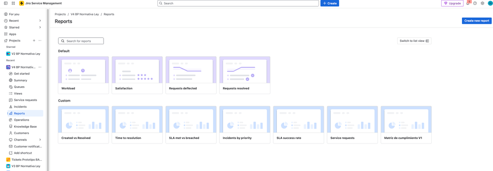

Hi, my customer has a very particular need: to see only certain request Types... but displaying fields that belong to OTHER REQUEST TYPES.
On the other hand, I need to display the linked issues again but renaming the column, even if it repeats.
To have a visual understanding please look at the picture with RED, GREEN AND BLUE stars.
Let us call
BLUE: "law"
GREEN: "requirement"
RED: "task"
I want to display only tasks, the reds. However I want to have available the info of the green and blue custom fields (green & blue hexagons).
The hierarchy is:
A BLUE LAW contains  GREEN REQUIREMENTS and these ones contain RED TASKS (the only ones I want to display in the queue.
Now about the linked issues
you might see the column "Links".
I only want the RED TASKS.
Is there a way I could duplicate the link column but instead of giving me the key "V4-68" it gives me back the name (Summary) of the GREEN REQUIREMENT?
and again...
Is there a way I could duplicate the link column but instead of giving me the key "V4-67" it gives me back the name (Summary) of the BLUE LAW?
and Finally
If this is too complicated, do you think I could handle all this with some sort of report?

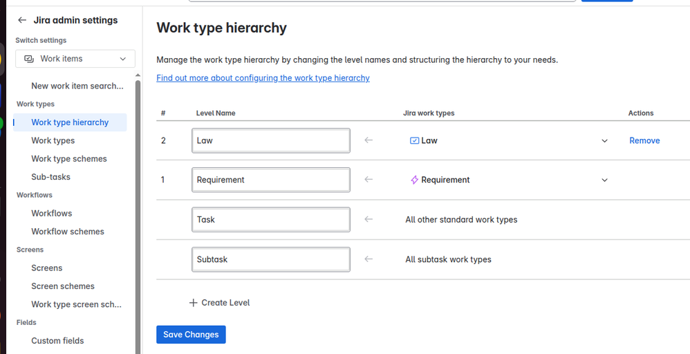

Hi @Sebastian Santoyo,
I haven't tried it on a JSM project, but it might work to add additional levels to the default Jira hierarchy if you use the Plans feature (aka Advanced Roadmaps) - now available with Premium and Enterprise plans. This would allow you to implement the hierarchy you need and then use the parent-child relationship for all these items (instead of the issue link).
Danut.

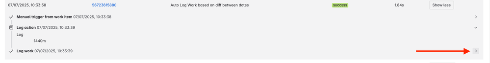

What output are you getting in the rule's Audit Log when the rule executes?
Make sure to click on the ">" arrows to the right of the messages to expand all the details.
