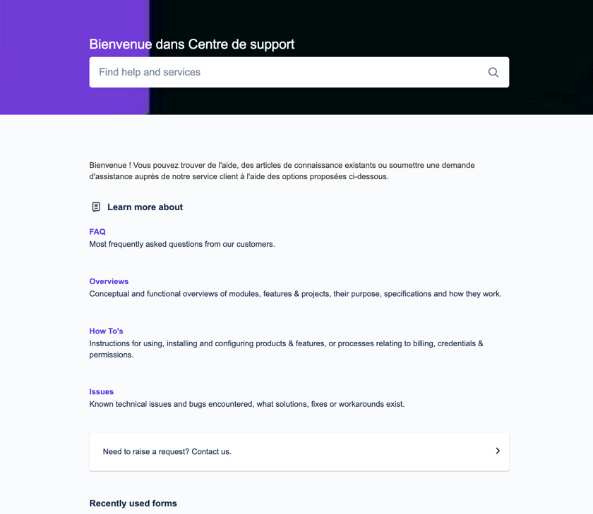

Attached below is an example of what the user experience is at present, a very unsatisfactory jumbled mess...
Thanks,
Oli

Unfortunately, as others have also said, what you are trying to achieve is not currently feasible due to several technical limitations.
The best solution in your case is probably to create a separate portal for each language you wish to support.
