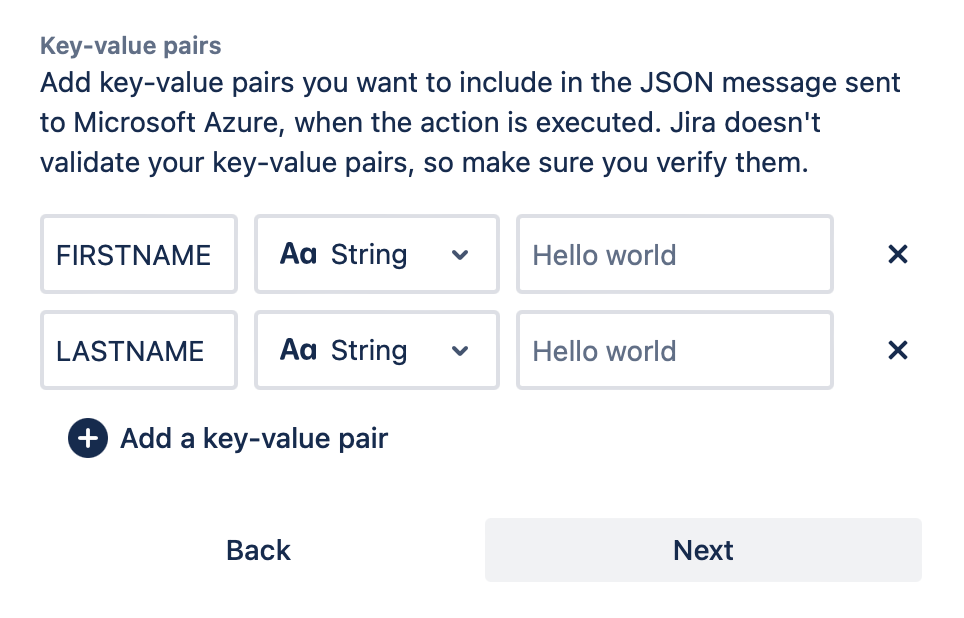

Hello! I am looking for help on how to setup key-value pairs on a Jira form that will trigger an automation to start runbook in Azure. (https://support.atlassian.com/cloud-automation/docs/jira-automation-actions/#Start-runbook-in-Azure)
In this case, I want to pass the values from my form fields to Azure:
FIRSTNAME and LASTNAME are the keys that Azure is expecting... what do I need to enter in the value fields to grab the corresponding data from the form fields?

The action to start runbook in Azure, is not able to use smart values (values from other fields to be used in other automation actions or conditions)
So in this case I don't see that the request you have is possible, as you only can specify a key pair in the action directly.

In the action "start runbook in Azure" you can set defined values, but these values can't be provided by input in fields in an issue.
This can only be done by using automation smart values, but the action "start runbook in Azure", can't use smart values as stated in the documentation.
The values you can use in the action are values in Azure, as the action already requires you to connect Jira with Microsoft Azure.
So the details you can provide in the action, are values, that exist in Azure, but can't be taken from fields in Jira.

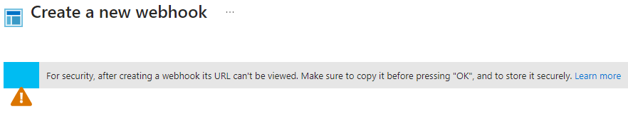

Add a webhook to your Azure runbook. This will generate a URL that includes a unique token. You need to copy the webhook URL before you finish creating the webhook because you cannot get it again later.
I store these in the secure vault of our password/identity management tool in case I need to refer to it again.
