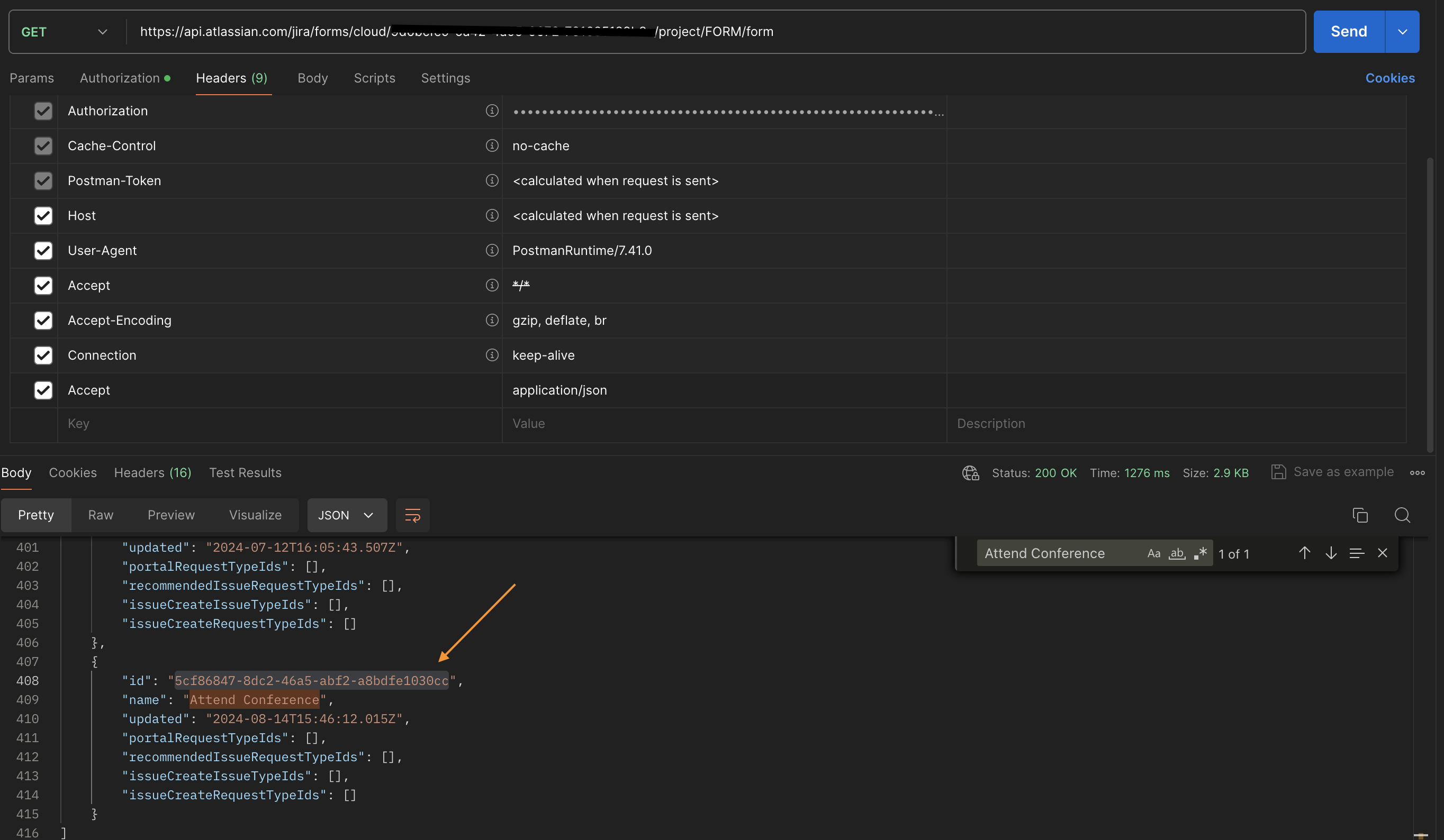

  1. Retrieve form template IDs from a project using this API:
    https://api.atlassian.com/jira/forms/cloud/{cloudId}/project/{projectIdOrKey}/form
    This will return all forms for your project, allowing you to identify each formTemplate ID.

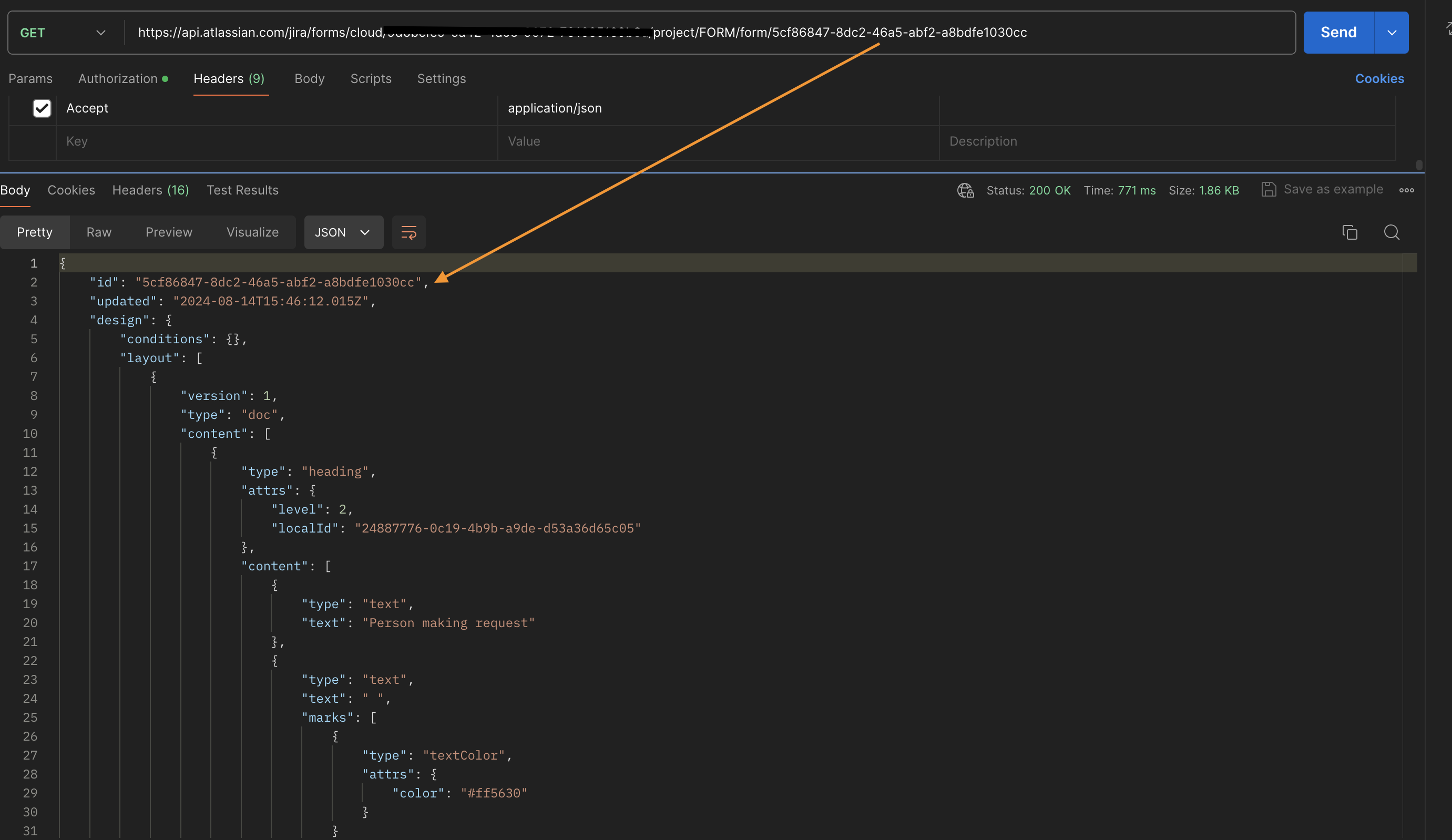

  2. Access the properties of a form template:
    https://api.atlassian.com/jira/forms/cloud/{cloudId}/project/{projectIdOrKey}/form/{formTemplateId}

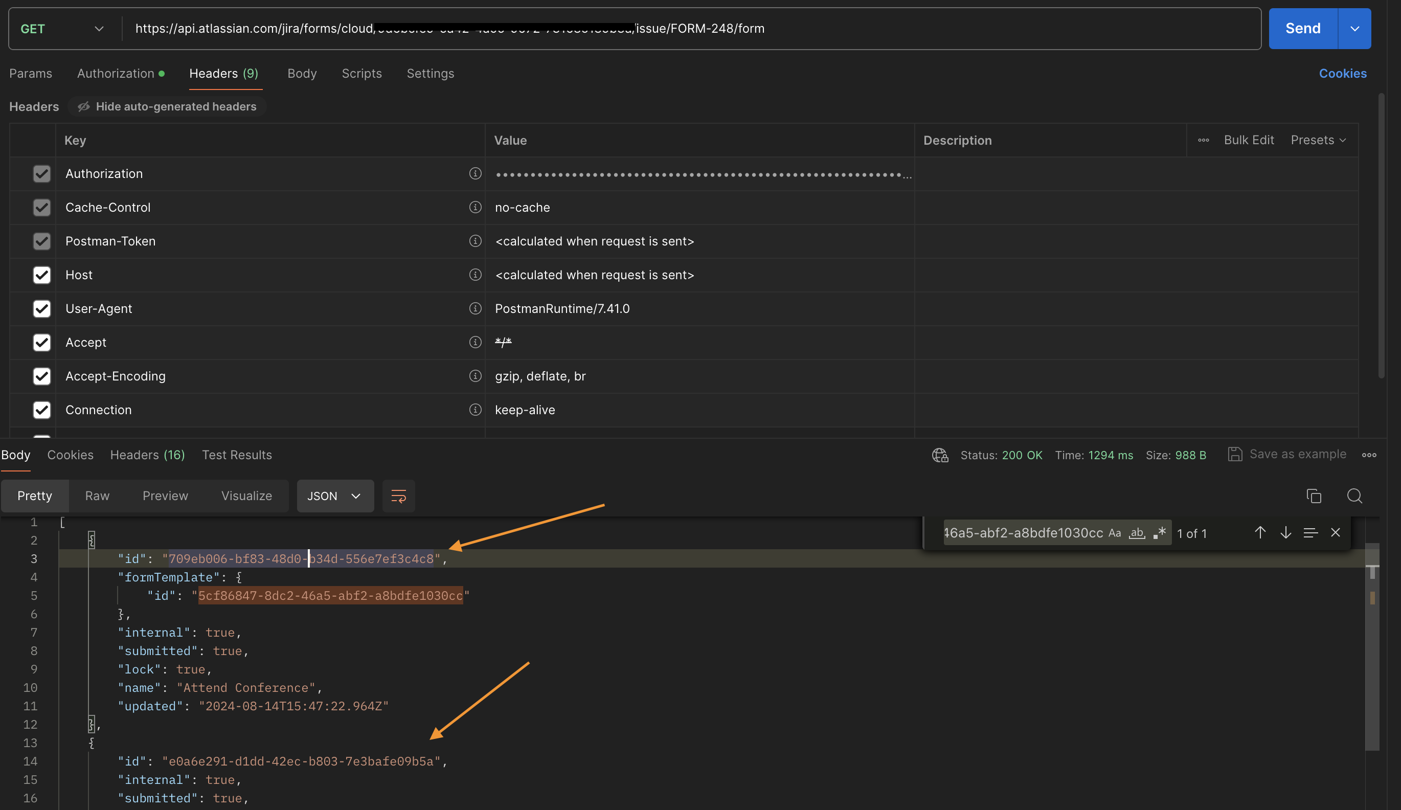

  3. Get form IDs from an issue using this API:
    https://api.atlassian.com/jira/forms/cloud/{cloudId}/issue/{issueIdOrKey}/form
    This will return all forms from an issue, enabling you to find each form ID.

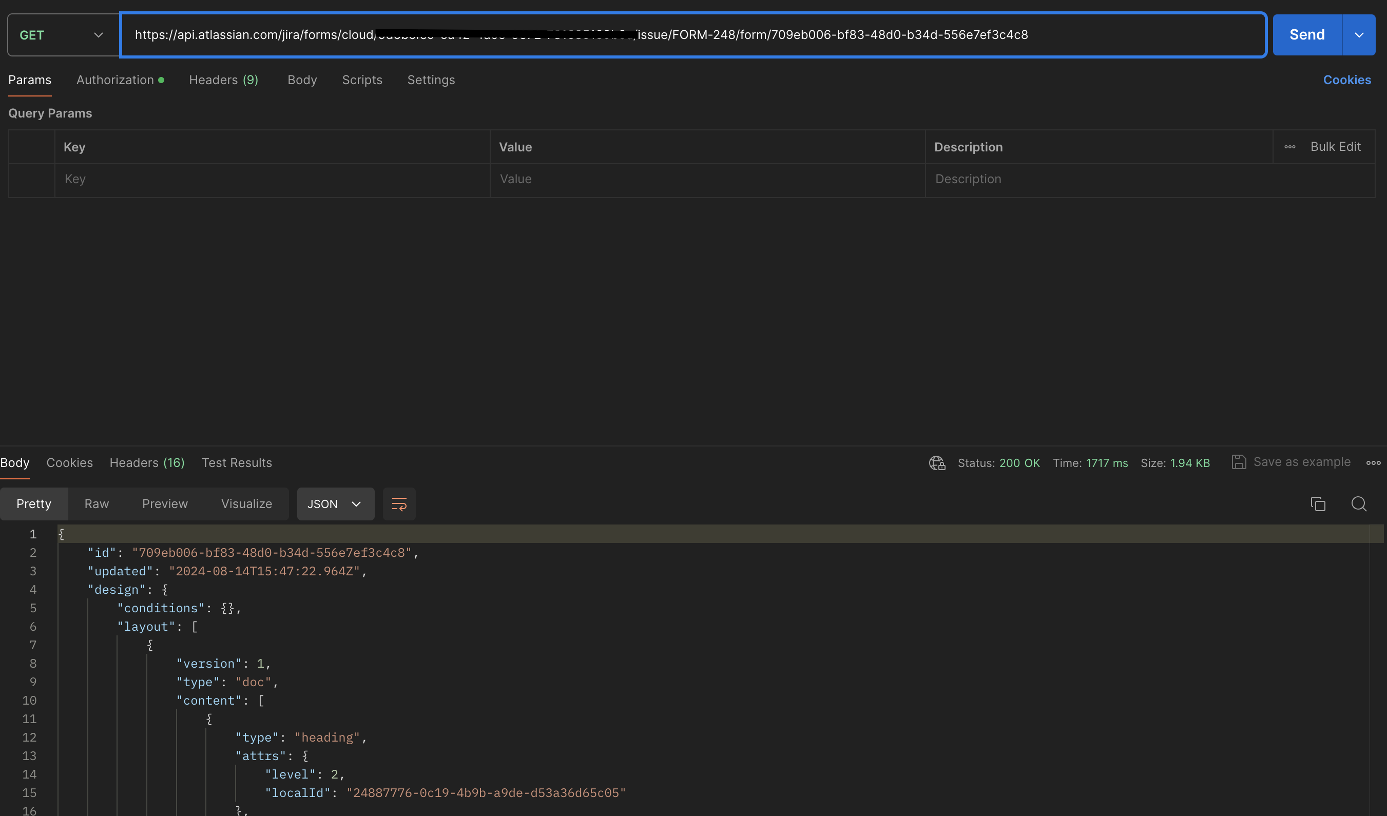

  4. Access form properties and responses from a form attached to an issue:
    https://api.atlassian.com/jira/forms/cloud/{cloudId}/issue/{issueIdOrKey}/form/{formId}

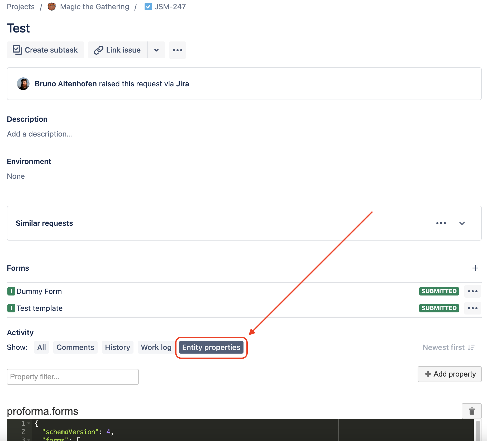

Workaround steps:
With the Entity Property Tool for Jira installed, add the desired form to a ticket and navigate to the Entity properties tab, as shown in the screenshot below:
The structure to access data is as follows, where AAA is the question ID number (not the Question Key):

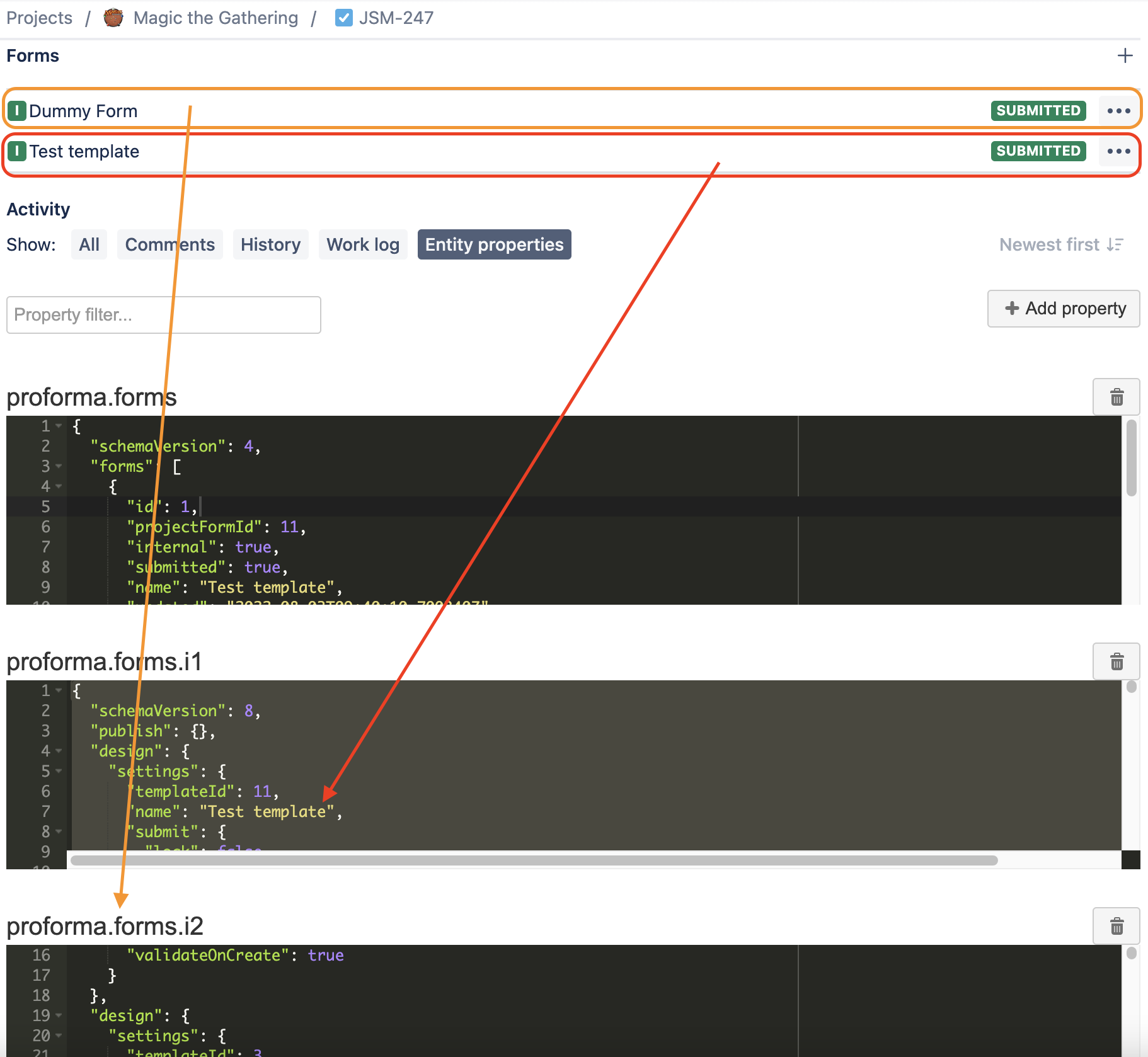

In the Entity property box, entries like "proforma.forms.i1", "proforma.forms.i2" indicate the form's order:
Using a code editor like Sublime, you can paste form properties and find desired fields and IDs, as shown in this screen recording:

Tip: The "i1" is the number of the form attached to the ticket. So if you have 3 forms attached and want to access the second, it will need to use "i2".
I have 3 forms in my issue in a certain fase of the processes.
The second is the one of my interested.
For some reason we didnt find any information this ID may change for the same form, and we are seeing an i4 on the same form
Second issue - the i2 is still in place, and the new one i4, have the most recent data. Do you know if this is a bug?
Any way to not having this happening?
- The steps
I submit  the 2nd form once i2
SOmetimes I need to reopen for edits - I reopen for customer Edits, and then the form is submited again.
At this point, the i2 remains there in the properties, and a new one with new info is created as i4.
The 3rd time I change the form the same way does not create a 5 or 6 id for the same form.
With this ID changing I Cant rely in the automation for 2 reasons:
- If i use the old id i2 it wont get the current data
- if i use 2 different automation to point to i2 and another to i4 what will happen is that depending on what was the first one worked by automaion i will have the wrong information.
