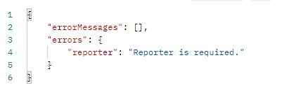

Bhakti Thaker
December 2, 2021
yes, we tried it with reporters
and we are getting such as response

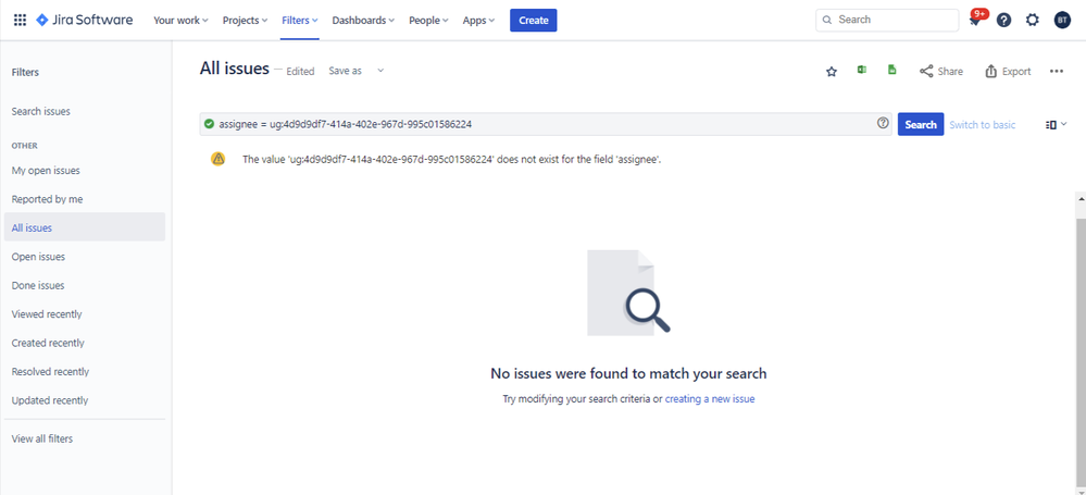

  3. Paste the JQL in the editor: assignee = ug:4d9d9df7-414a-402e-967d-995c01586224
Bhakti Thaker
November 29, 2021
Thank you @Daniel Turczanski - JQL Search Extensions .
