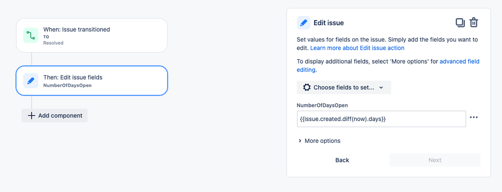

Kris Dewachter
January 22, 2024
Hi @Igal Altshuler ,
Create a "Number" custom field that you can use to store the calculated number of days.
You can set a trigger on a transition to the 'Resolved' state.
In the automation rule use the 'Edit Issue Fields' action to set this field by using this calculation :
{{issue.created.diff(now).days}}
Best regards,
Kris
Igal Altshuler
January 22, 2024
Thank you very much!
