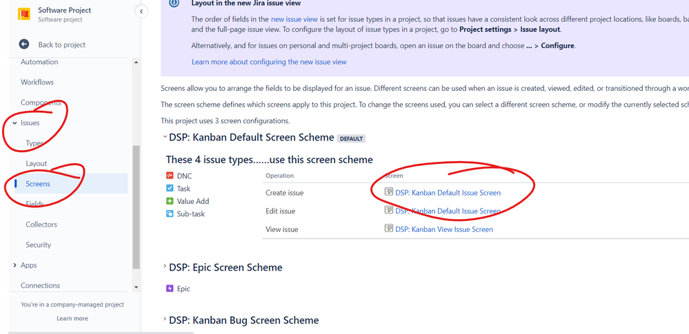

Before doing anything, you have to make sure that the screens are not sharable with any other issue type.
  • Project settings
  • Issues
  • Screens
  • Click on the create screen of your issue type
On the screen you will see, search for resolution field and remove it.

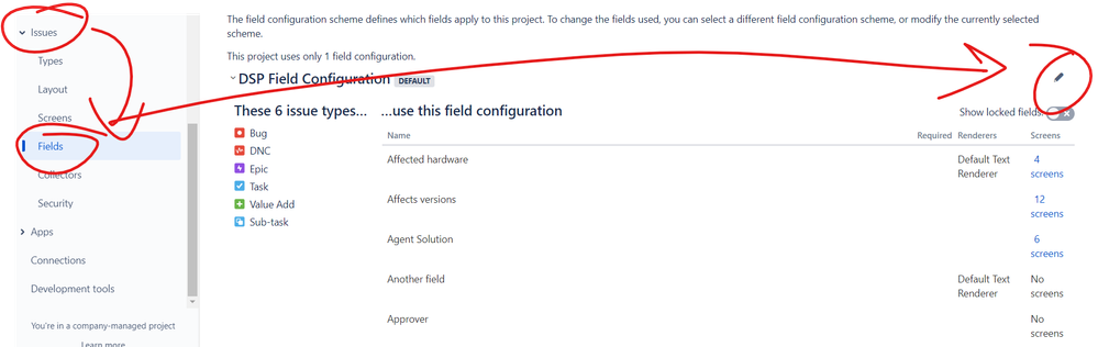

Field Config:
After pressing the pencil, search for the resolution field and see if it's set on optional or required. Keep in mind that this field configuration will impact all issue types associated with it. In the example below, you can see that it's associated with 6 different issue types.
