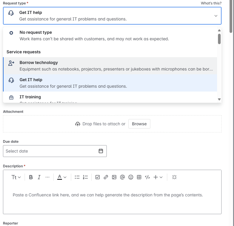

I have created a service request as an example and then we have different request types for the service request, for example “Get IT help” or “Borrow Technology”. If I now select "Get IT" help, how can I change this afterwards?
I only know that when I create the ticket, I can change/add it there in the mask, but how can I change it afterwards?

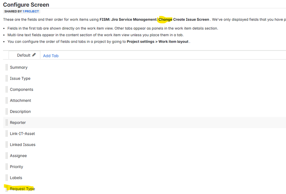

Hi @Susan Waldrip ,
thank you for your answer. Unfortunately, I can't find a solution in the community post below. When I go to Screens and click on Change in the screen, for example, the “Request Type” field is already there but it does not appear in the work item. Do I have to change the workflow so that the work item view or the screen opens?
Like Susan Waldrip likes this
Susan Waldrip
July 9, 2025
Hi @Antonia , there may be two things to check based on your screenshot (thank you, always helplful!). First, the screen you're adding Request Type to is the Create screen, which is the screen the Customer uses to create and comment on their request. Are you wanting the Customer to be able to change the Request Type? If so, this cannot be done by the Customer in the Help Center portal, it would have to be done by the Agent.

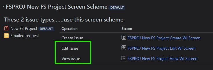

For the Agent to do it, you'll need to:
1. Add the Request Type to the Edit/View screen or the Edit and View screens (if you have separate operational screens) so the agent can see it (View) and change it (Edit).

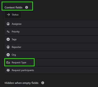

2. On the Layout screen for the agent screen (Work Item view), make sure the Request Type field is located in the second section, Context Fields.
Try that and see if it works.

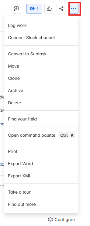

Hi @Antonia
I guess you can change it after, it’s just a bit hidden.
Open the ticket, hit the three dots up at the  top, then pick “Change request type.” That’s it.
Antonia
July 9, 2025
Hi @Priyanka Khare
thank you, but there isn't the option.
