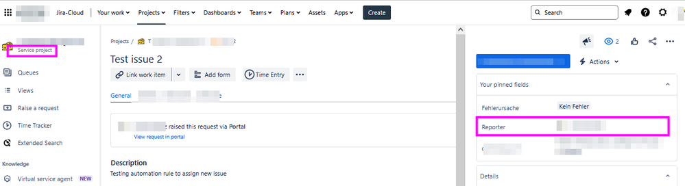

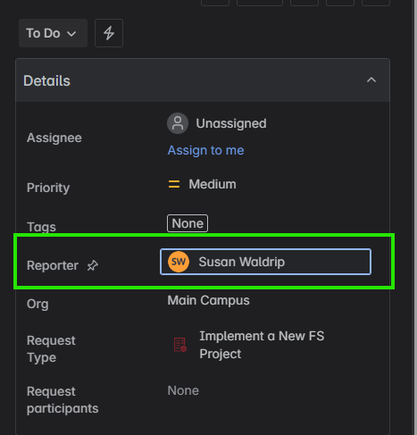

Hi @Jochen Betz , I must not understand your request because I'm using JSM (we don't have Jira software/platform). Would you please post a screenshot of your screen so we might provide better suggestions?
Sure I can, but there is nothing different from your screen shot except that reporter cannot be changed.
BTW: Person logged in and reporter are the same person aka me which is admin of the project.

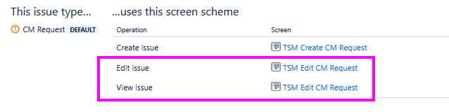

Did you add Reporter to both Edit and View operational screens (or the Edit/View screen, if that's your configuration)? If so, then I'd suggest contacting Atlassian support at https://support.atlassian.com/contact, they should be able to see if anything's going on w/ your instance and provide a solution.
Yes, because they use both the same screen.

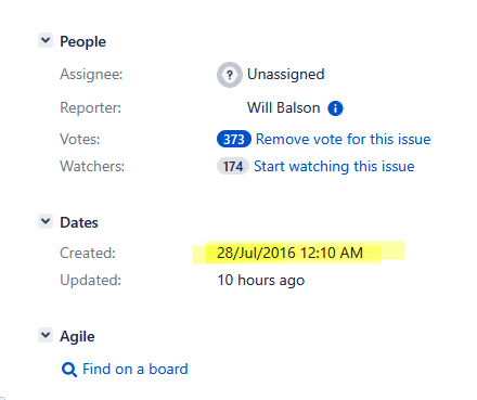

Hi @Jochen Betz - It sounds like what you are really looking for is the ability for a customer to raise the issue on behalf of someone else. You can vote for and follow that request here:
https://jira.atlassian.com/browse/JSDCLOUD-4102

Voting for an issue at atlassian? ... not intending to work that long in my life to see it become closed (not even saying fixed); more likely because "not implemented".
Sorry for that permission, but reality proofs it.
And looking at the exact issue you are referring to... 9 years seriously? Nowadays SW companies don't even exist that long anymore.
And still..... nothing happened: UNASSIGNED
That's what Atlassian calls "We listen to our customers". Well "Listen" yes, act? No.

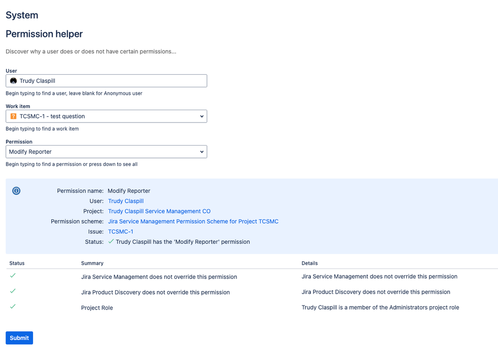

Have you tried using the Permission Helper to see if that reveals any more information about why the Reporter can be changed by a specific user in a specific JSM issue? That tool is available to Jira Application Admins through the System settings.
Thank you @Trudy P Claspill for the longer explanation and looking into the topic.
Let me roll up from the bottom:
Yes, I have used the permission helper. And even myself as admin and with service agent license can NOT change the reporter, albeit the permission helper says I should (all green)
