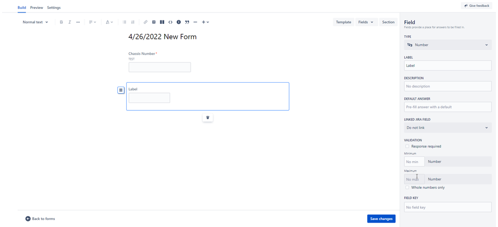

Hello @Andrey Rudnev
Thank you so much for the swift response :-). This is very helpful. I have followed all the steps you have advised. I would like to know if i could be able to see the changes on preview of the new form to know exactly what the customer is seeing ? At the moment its currently not visible at the top as i thought it would be. currently it look's like this
New form.PNGAgain, thanks for taking the time to thoroughly explain this to me
Andrey Rudnev
March 3, 2022
@Nontobeko.gumbi Your are welcome)
There is one problem with your request: you can see how your form will be displayed on the portal in the Preview tab in FORMS, but only WITHOUT those fields that you configure directly in Request types -> Your request type -> Request form -> Visible fields. I propose the following solution for your request: "Your Project" -> Channels -> Open Help Center and right there you select your request type and you can see it as the customer sees it.

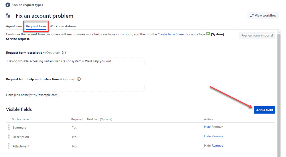

Joseph Chung Yin
February 7, 2022
@Andrey Rudnev -
You just need to add "Attachment" field by -
1) In your JSM project, access "Project settings" (assuming that you already have project admin right).
2) Access "Request Types" option and select the specific request form in your request types listing - Clicking on the form name.
3) Click on the "Request form" tab and click on "Add a field" to add "Attachment" field to your request form.
Hope this helps.
Best, Joseph Chung Yin
Jira/JSM Functional Lead, Global Infrastructure Applications Team
Viasat Inc.
Andrey Rudnev
February 7, 2022
@Joseph Chung Yin Thanks for your answer but I told about new feature which is name "Forms". I created new form with many other field but i can't add Attachment field. Sorry, if my question confused you.
