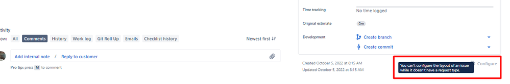

I have prepared a new JSM Project, for that i had defined several Custom Fields. Additional, i need the Sub-Task in cases of escalations. My Problem is, that i can't configure this Fields:
The Message tells to me, that i need a "Request Type". Ok, i had tried to create a New Request Type for Sub-Task, but that was not possible, i can't choose Sub-Task Issues for creating a new Request Type:

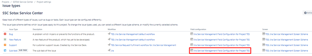

So i have tried to remove the fields in the field configuration of the project. But yes, when i remove a field, it appears also not anymore on the other Issue Type, where i need i definitely:

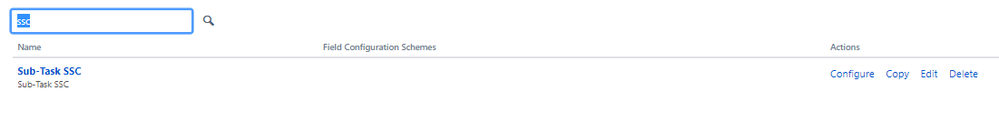

Ok, also the wrong path... i asume, that i need a different Field Configuration for the Sub-Task, so i have created a new one:
But, i can't assigne it to Sub-Task ussed in my JSM Project!...

You've nearly got it.  The step you need next is to go to the "field configuration scheme" for the project and edit that.
It will show you a list of issue types, mapped to various field configurations (quite probably though, as I'd guess you have not edited this yet, it'll probably just say "default: TES").
You should add all your sub-task types into this list, mapped to "Sub Task SSC.

yes indeed a subtask cannot be associated with a request type. Request types are only associated to a 'parent level' issue type. This makes sense given that you cannot create a subtask without first creating its parent. With that said you certainly can have subtask as an issue type in your JSM project. To do so simply go to project settings and then issue types. And the screen you can add additional issue types and should be able to add the subtask. What's the subtask issue type has been added then you should be able to create a subtask while viewing an issue in your project.
