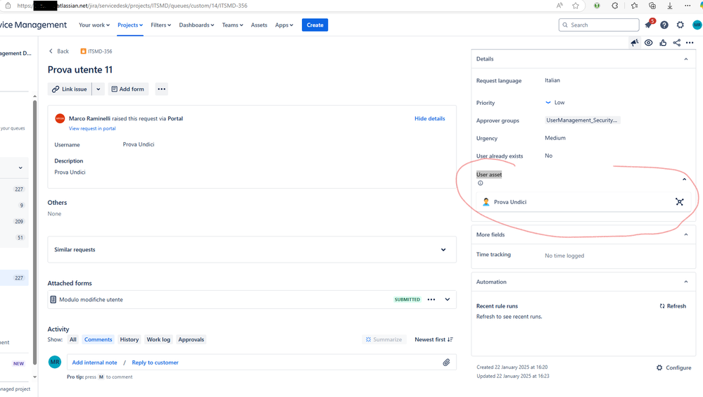

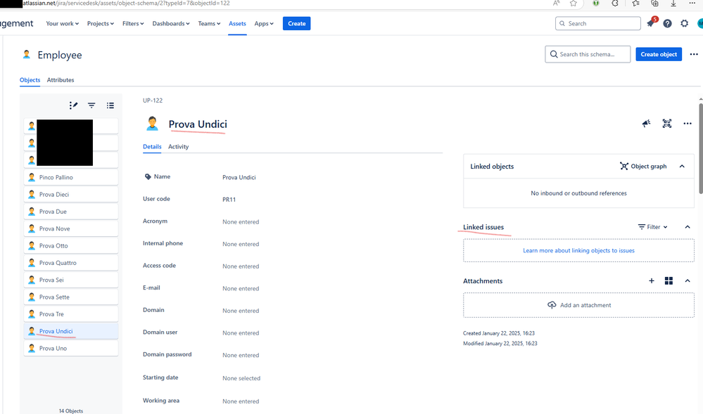

The automation create the object and add it in a the customfield in the issue. From it I can go to the Asset Manger object, but the link is not present in the list of Linked issues in AM.
If I manually edit the field, deleting and recreating the object, the link appear in Linked issues.
What's wrong?
Can you provide a screen image of what you see when viewing the Assets, where the issues are not showing up as expected? Perhaps I have misunderstood your reference when you say "Linked Issues".
Found the problem:
The link appears, but after a while. Until to 20 minutes!.
