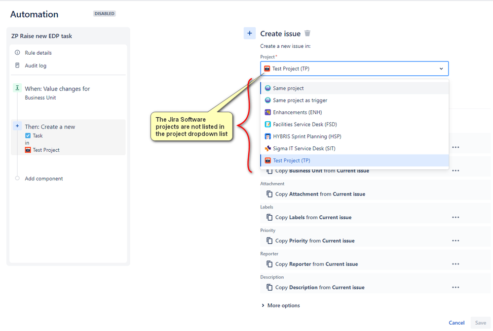

Hi all,
We got 2 instances of Jira: Jira Service Mgmt, used by internal and external users; and Jira Software, used internally for project kanban/scrum boards.
I wanted to create an automation when a ticket is created in JSM for a particular request type, it will trigger to create a new task in Jira Software.
How do I make the integration between our 2 Jira intances without a paid app?
In the automation action Create issue, I can only find projects within JSM. I cannot pick a project from Jira Software. What setup/config i need to have our 2 Jiras talking to each other?
Thanks.

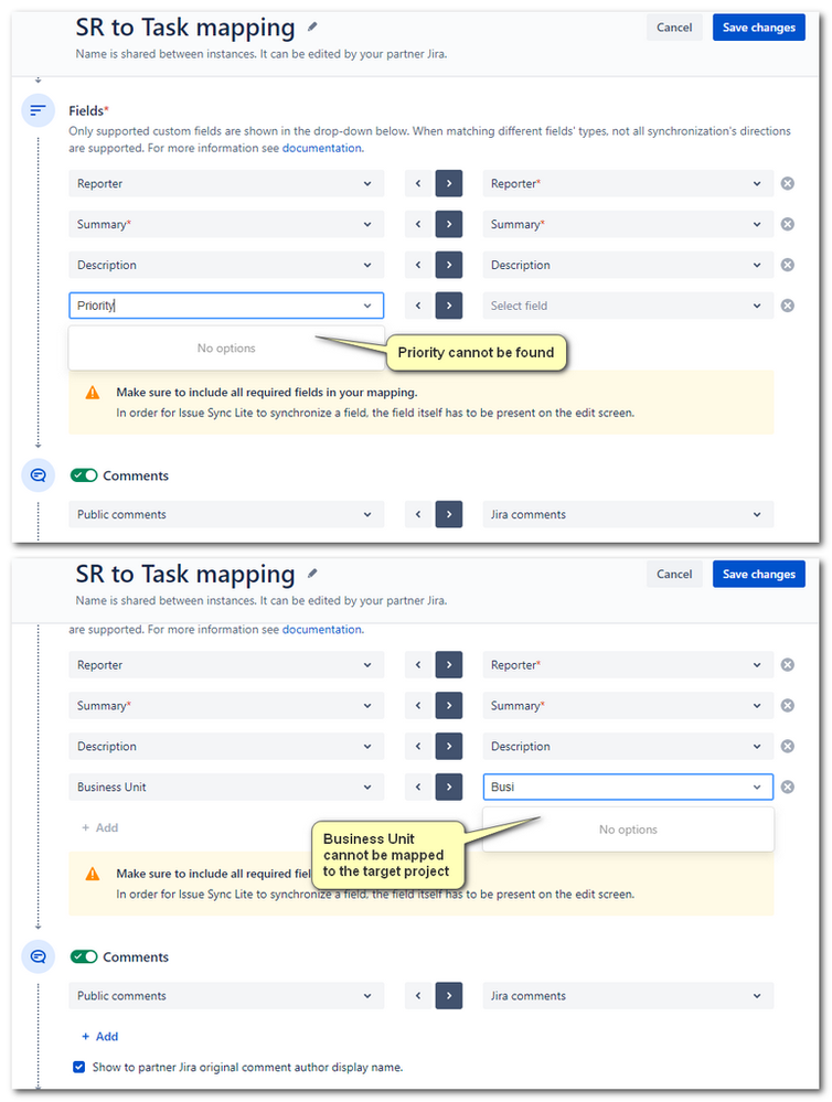

Few questions on this app...
1. How to sync standard fields, like Priority and Reporter? I can't seem to find them in the dropdown of available fields.
2. If the custom field is available from the source project, but I want to map it to another custom field to the target project with different fieldname; how do I do the mapping?
3. Is there a limit on how many fields to be mapped?
4. And, can you set condition to trigger the sync? For example I only want to do the sync when issue type = Service Request and category = Reporting.
Thanks for your response and suggestions.

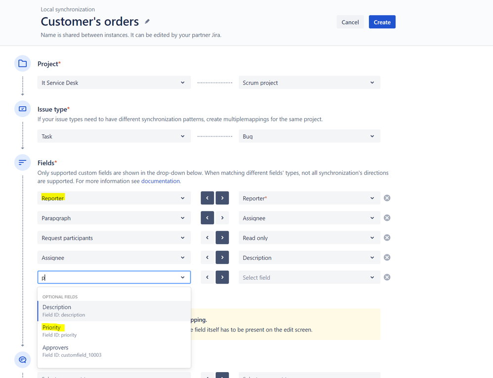

  1. Both mentioned fields - Priority and Reporter are supported - you can find them by typing their names in the drop-down, as shown on the screenshot. If for some reason you can't find it - please drop us a request via Customer Portal so our team can have a look at that.

With the missing fields in Fields mapping step, I made sure the the fields are present in both projects. And that all of them are visible in Create/Edit/View screens. But for some odd reasons, I still cannot pick and select the Priority field. I could be doing it wrong??? Hope the screenshots below will help....

Regarding the problem with the Priority and Business Unit fields -  unfortunately, I'm not able to reproduce it so I'm afraid that further details of your configuration will be needed to troubleshoot it.
Could you please raise a support request using our Customer Portal and provide us with both fields' IDs, type of Business Unit field, mapped projects types, and instance URL? Also, info on any errors in the developer console will be appreciated!

Ignore my updates above. I found out what keeping me to map the fields. It is actually the Screen configuration. What I did was, I created a new issue from the source project, and click the option  three dots (...) on the top corner and select 'Find you field'. That tells me if the fields is present in the screen.

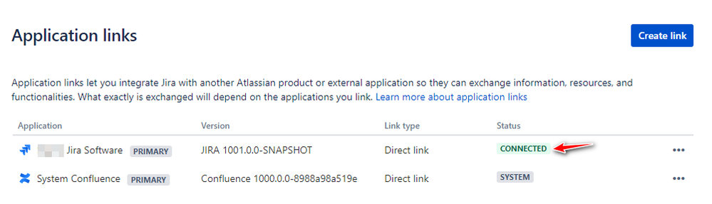

In order to accomplish that you have to do two steps:
  1. Create application link between the two instances
  2. Create an automation rule
The first step is important only if you want to link the two tickets. If you don't want to link them, then skip it. To create an application link you'll need to be a Jira Admin on both cloud instances. Then follow these steps:
  1. Cog wheel > Products
  2. Application Links
  3. Paste the URL for the destination instance
  4. Create new link > Follow the instructions per screen
The above will give you the ability to link issues between the two instances. Keep in mind that on both instance you have to manually allow this link by clicking allow.

I was able to create the application link....
But I still cannot find any project from our Jira Software instance.
Any idea why? Anything I missed in the setup?
Alex Koxaras -Relational-
March 20, 2023
Hi @Zaldy Parian
The application link will be used only to link issues between the two instances. You will not be able to create issues from the Jira Automation. You have to do the second step as well.
