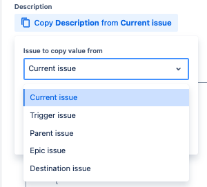

I have not found any documentation that indicates which fields (or a screen) used to underly the Clone Issue feature. Unfortunately I think you would have to use trial and error to figure that out.
The Clone Issue action in Automation Rules does give you the ability to set other fields as part of the action, and most (I can't guarantee all) fields provide an option to copy their data from another issue to make it easier to get the data you want.
Screenshot 2024-11-08 at 3.53.39 PM.pngScreenshot 2024-11-08 at 3.53.53 PM.png
