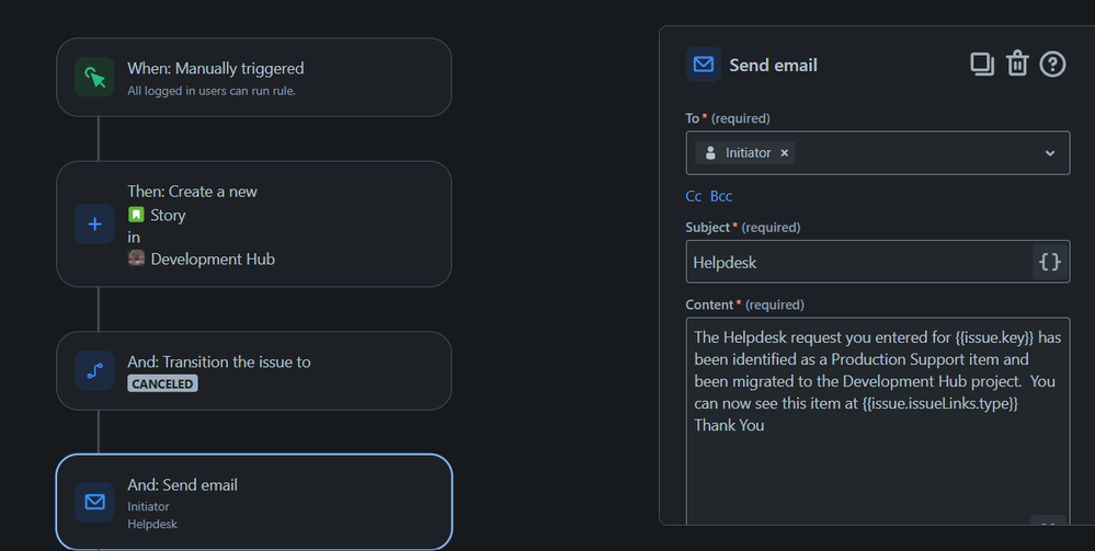

Ayush Lawania
April 15, 2025
I am not able to send email notification as mentioned in the request and also the status mapping as mentioned above.
John Funk
April 15, 2025
Have you configured the Rule Details to be a Multi-project rule? You need to include the Project from the Manual trigger and the Project where the Story is getting created. Or it needs to be a Global rule. Let's start with that first.
