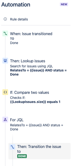

"Relates To" linking makes things difficult because you don't have an outbound/inbound link to reference and therefore as other tickets close, the rule can't clearly identify a "parent" (I use the term lightly) to associate.  You need to be able to execute a query where the service desk ticket is differentiated from the other links the issues may have.  Ideally, you want the service desk ticket to see the other issues as something like "Blocked By".
That stated, you could do something like what I have below to get the job done.  Basically the rule looks to see if there's only one remaining related issue open and assumes that last issue is the service desk issue.  Again, I would stress changing your linking behavior as the best practice for this, but in lieu of that, here's the rule:
NOTE - This needs to be a GLOBAL rule.  You want to try and limit project scope and/or add conditions to keep this from running rampant on your instance.
Mark Segall
March 9, 2022
As I posted that answer, I realized that if you never have a use case where two service desk tickets linked to each other, you can use this JQL instead and remove steps 2 and 3:
relatesTO = ((issue}} AND status = Done and issueType != <your service desk issue type>
This would also provide more certainty.  However, this is out the window if you potentially link service desk tickets together.

My pleasure.  Based upon the fact that service desk tickets will never be linked to each other, you can accomplish this without the Lookup and Advanced Compare steps then.

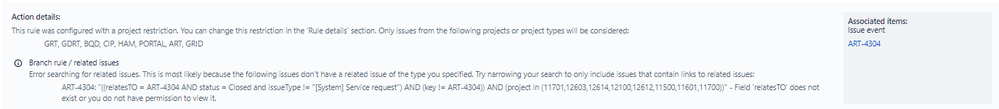

This is my current setup/result (screenshot A and B) Closing the jira improvement ticket didn't close the SDHELP ticket that was linked.
I used the status 'Closed' instead because that's our final/final status meaning the ticket is released into PROD. I did notice an error on relatesTO (something about it not existing or not viewable)

here's the log error: SceenshotC.png

Hi @Daniel Ramezani - Sorry the JQL query should be this:
issueRelatesTo = ((issue}} AND status = Closed AND IssueType != "[System] Service Request"

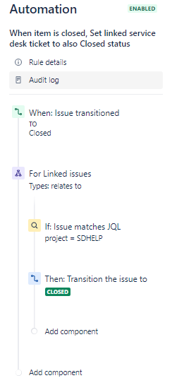

Ok issue resolved finally... @Mark Segall thanks for the guidance. I made up a whole another variation of steps and also had to set the 'Closed' status in the service desk project workflow to "Allow all statuses to transition to this one".

I'm glad you got this working.  My approach was working with the assumption that there may be multiple issues linked to your service request ticket.  So the query was supposed to be validating that all issues that weren't your service request ticket were resolved.  Though revisiting it now, I see the flaw in my logic because you'd never branch into the service desk ticket.
So, if you do need to solve for cases where there are multiple links, you'd want something like my first screenshot, but replacing the branch JQL to:
IssueRelatesTo = {{issue}} AND Project = SDHelp
