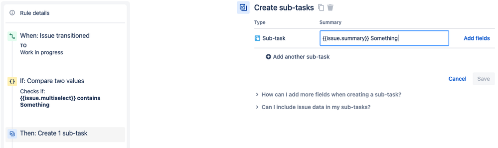

The automation for this should be pretty simple to do, something like this would do it:
Just add a "Compare two values" condition for each value in your multi select that should generate a subtask. Because in this case I use subtask it will automatically be linked to the main issue so you do not have link them. You could use a standard issue type too and add the link as part of the create component.

Awesome, thank you so much!  I figured it wasn't complex, just complicated enough to not be a clear configuration for me.  The {{issue.multiselect}} - does this pick up the multiselect function automatically or do I need to reword that to reference a custom field I created?  Do I need to create a separate automation for each role?  So if multiselect contains Safety, create subtask {{issue.summary}} - Safety Approval.  Then create a new automation with the same setup for each role after that.

So the {{issue.multiselect}} would be the name of your custom field. You can either use the display name, or if you have multiple fields with the same name, or if you may end up renaming the field in the future, you can use the custom field ID instead. You can get the ID if you go to Settings > Issues > Custom fields and locate the field and then click on the three-dot menu and just hover over one of the options. The URL will contain the ID at the end.
So, if your multi select field is called Positions approval, then the smart value would look like this:
{{issue.Positions approval}}
I would use multiple "Compare two values" component instead of having one automation for each role. Just be aware that automations have a limit of 65 components within a single rule.
