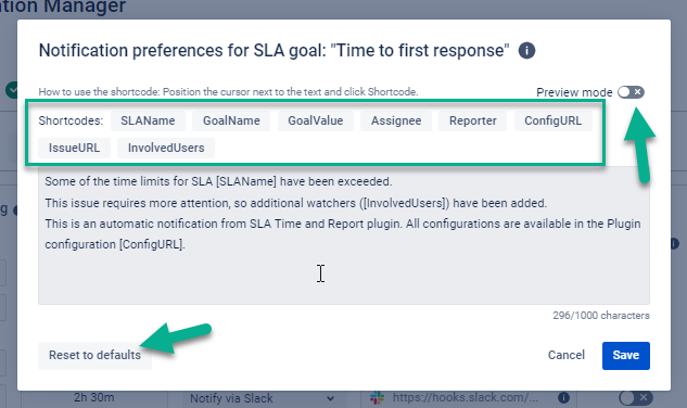

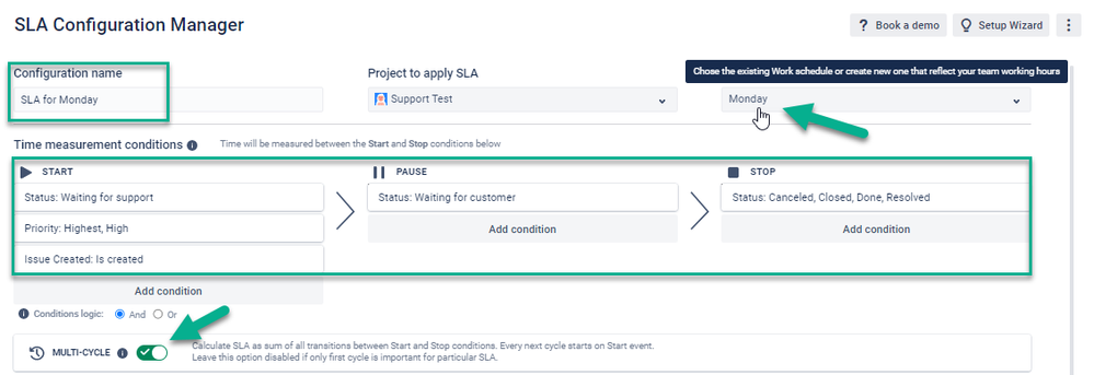

If you don't mind using third-party add-ons, I'll just show you a simpler way to solve this problem using SLA Time and Report for Jira.
In your case, it will be necessary to create 2 SLA configurations, where the first SLA with a Calendar for Saturday and the second one with a Calendar for Monday. If required, you can configure the SLAs for different time zones and work schedules.
Example for Monday SLA:
1) Select the Monday calendar and set up the START/PAUSE/STOP conditions.
2) Choose the required SLA Time goals, and the Limit exceeded actions.
Use the Notification template editor for your custom message.
3) Save. Do the same for Saturday.
You can use the 30-day add-on trial to check how it suits you.
