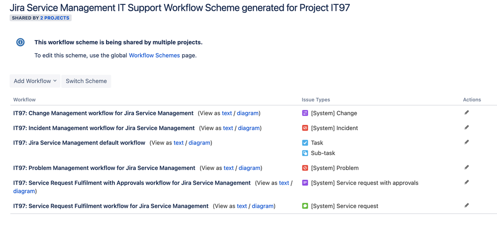

  1. From your project, go to project settings, then workflows;
  2. Select the workflow from the issue type you want to change and click on Edit under the Actions column;

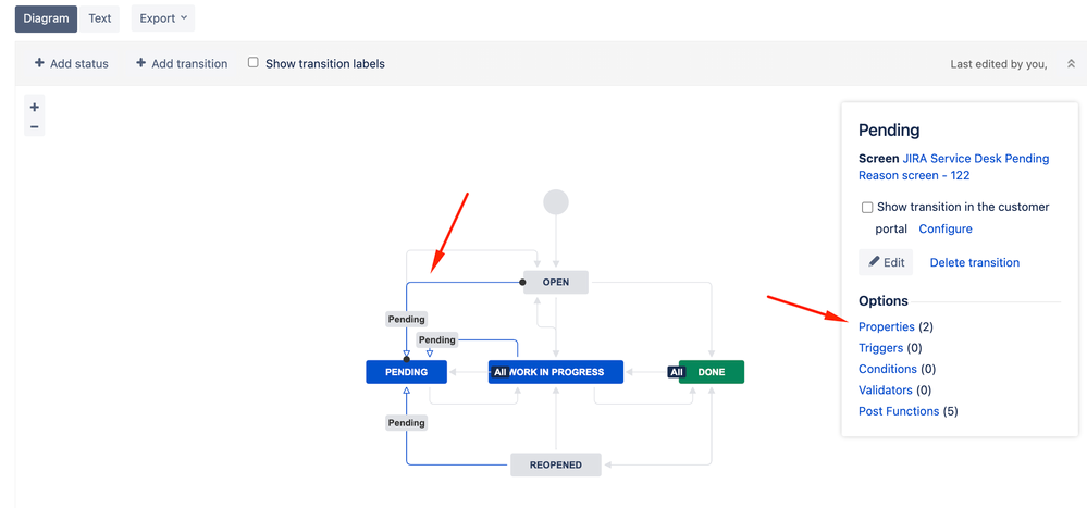

  3. From the diagram or text mode, select the transition that you want to reorder and click on Properties, it can also be used on Global Transitions;

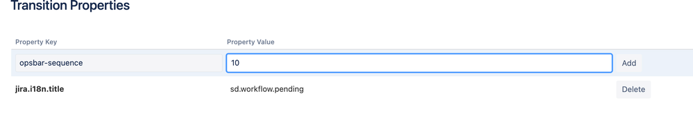

  4. In the transition properties screen, add the opsbar-sequence in the Property Key column, and the numerical value in the Property Value column and Add;

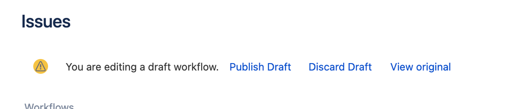

  5. Go back to the workflow screen and publish your draft workflow after you make the change to all the transitions needed.

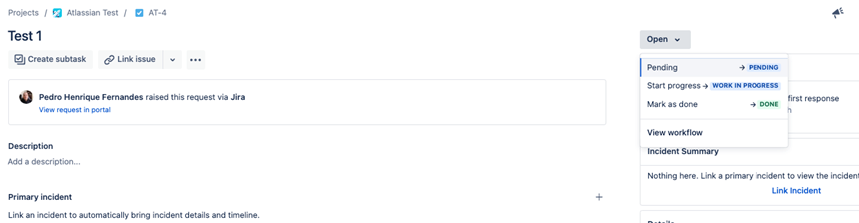

Example before editing the transition:

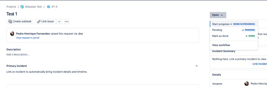

Example after editing the transition:
