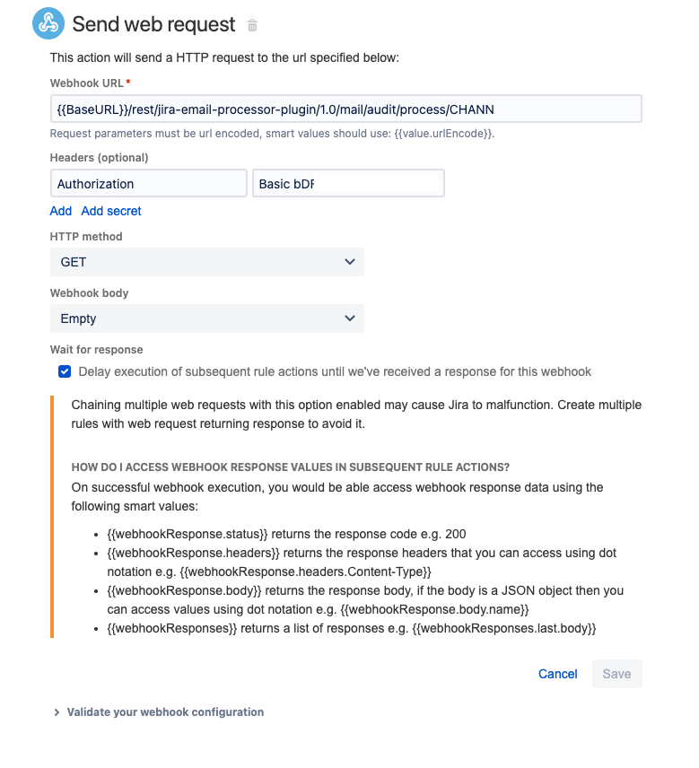

Hi @Mark B Wager
The API seems to work correctly. If I switch to another user that is not a project administrator or incognito mode, it fails.
I get this data from the API string.
{"data":[{"id":17234,"mailChannelId":11,"mailItemId":17234,"handlerName":"Service project Mail Handler","resultStatus":"FAILED","message":"Current user is not active","fromAddress":"inactiveuser@jira.nu","mailChannelName":"emailchannel@jira.nu","subject":"Sv: Radera domän","issueKey":"","noOfRetry":0,"updatedDateTime":"2024-11-28 09:34","createdDateTime":"2024-11-28 09:34"},{"id":17227,"mailChannelId":11,"mailItemId":17227,"handlerName":"Service project Mail Handler","resultStatus":"FAILED","message":"Current user is not active","fromAddress":"inactiveuser@jira.nu","mailChannelName":"emailchannel@jira.nu","subject":"Radera domän","issueKey":"","noOfRetry":0,"updatedDateTime":"2024-11-28 06:27","createdDateTime":"2024-11-28 06:27"}],"totalPages":1}
I attached an image for the web request settings.

tobias
December 10, 2024
@Mark B Wager
Does this article apply to Jira data center, or is it just for Jira cloud?
I've tried with my own user (global Jira administrator) and API key, and the automation still keeps failing. If I paste the URL into my browser, it returns the correct data.
If I switch to Bearer instead of Basic and my access token, the automation "succeeds", but the webhook returns no data (I tried changing from true to false) and the e-mail that got sent was empty.
tobias
December 10, 2024
@Mark B Wager
We finally got everything to work
* We switched to using Bearer instead of Basic
* Instead of API key, we are using Personal Access Tokens
* "webhookResponse" instead of "webResponse"
Thank you for your help!

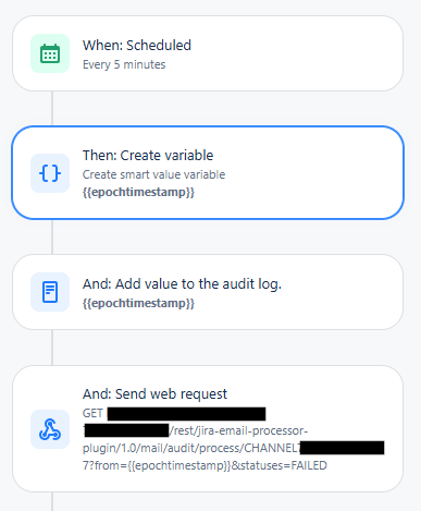

Cyril
January 27, 2025
Thank you Yuri for this workaround and all for the additional tips
It works fine for me as long as I do not use "from={{epochtimestamp}} in the get request.
As soon as I use it, I get an error 400...
[mysiteURL]/rest/jira-email-processor-plugin/1.0/mail/audit/process/CHANNELxxxxxx?from={{epochtimestamp}}&statuses=FAILED
I have tried several {{epochtimestamp}} values, but whatever I use, it always fails... Any idea ?
(even with only {{now}} in the variable, it fails)
Log (of the variable)
2025-01-27T13:15:25.8+0000
Send web request
27/01/2025, 14:15:25
Unable to publish the web request - received HTTP status response:
400
Error found in the HTTP body response:
Thank you in advance !
Cyril

Cyril
January 27, 2025
Hi @Mark B Wager
thank you for your feedback.
I did create the variable (and added a log to be sure it was correct when I saw it was failing)
Whatever the smart value in the variable, it always fail. (I have tried a lot, including the ones proposed in this thread)
below the automation
I really don't understand what I am doing wrong...
thx
Cyril.

Cyril
January 27, 2025
Hi @Mark B Wager ,
I found the issue - the time was not turning into a real epochtime, but still having a formated date
I found out by re-writing the variable instead of using copy-paste (maybe an hidden character somewhere)
before (not working)
after (working)
1737952829520
All good now !
Sorry for the disturbance and thank you for the assistance
best
Cyril.

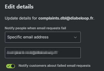

Térence LECROIX
March 11, 2026
Hello,
is this procedure still usefull as of now we have the possibility to define an email to get notified when an email requests fail ?
