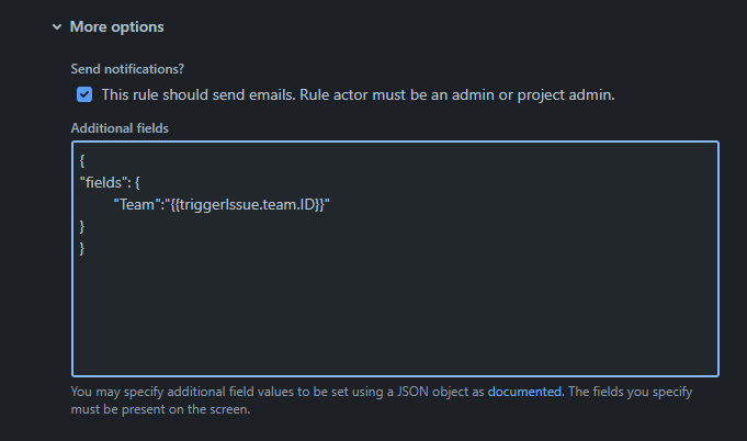

I would go about like this.
Trigger: Field (Team) has been edited
Condition: and Team is not empty
Branch: by JQL
issue in portfolioChildIssuesOf("{{triggerIssue.key}}")
Action (on the branch): Edit issue. And populate the team using as below.

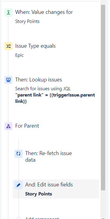

Can you please also help me on this.
When story points for epic is updated, it should automatically update the story points in parent (Portfolio epic), for eg if the aa-1,aa-2 is the epics, aa-3 is the portfolio epic, if we update the story points for epics aa-1, aa-2 it should automatically update story in portfolio epic aa-3

Yeah i tried this way,
1) Value changes for story points
2) Issue type equals epic
3)then look up issues "parent link" = {{triggerIssue.parent link}}
4) For parent branch
5) re fetch issue data
6) edit issue fields story points {{lookupIssues.Story Points.sum}}
Please let me know where i have done the mistake
Curt Holley
May 25, 2023
As mark point out here When story point in epic is updated, it should upd... (atlassian.com) your branch needs to be getting the Parent Link from the issue (in this case, the Epic)

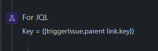

Curt Holley
May 29, 2023
if you make your branch this, the rest should work.
