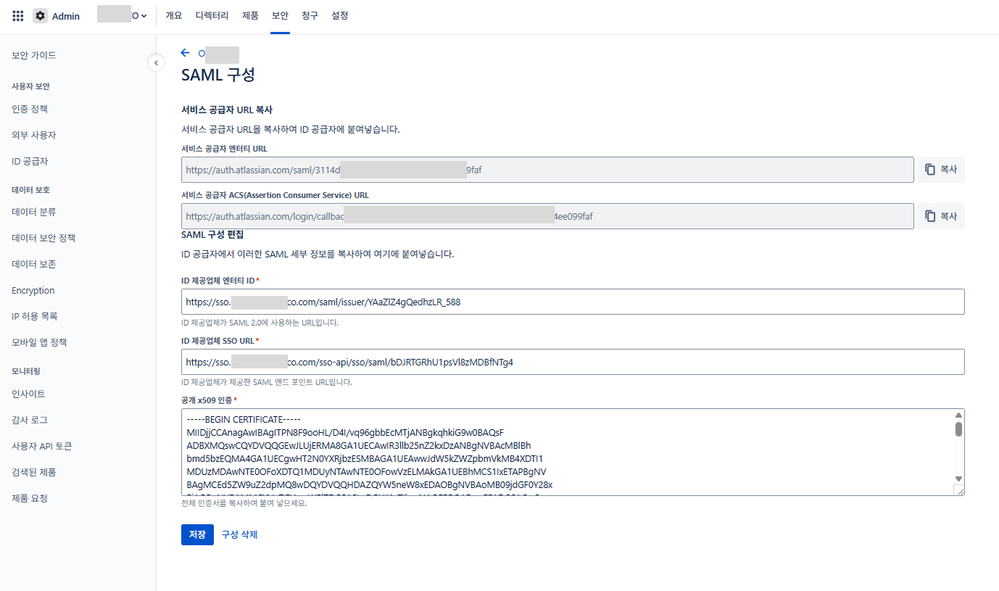

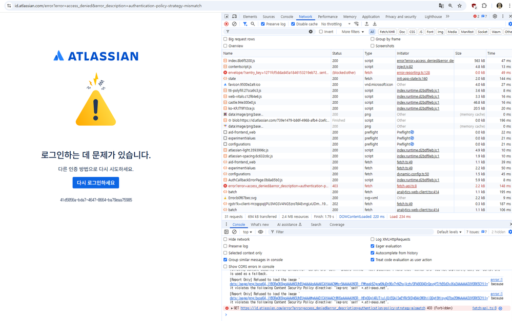

We’re currently running an IdP-initiated SAML flow, but when we’re redirected to Jira we see this error in the log:
error: access_denied
error_description: authentication-policy-strategy-mismatch
Could this be happening because our Atlassian Guard subscription is Standard, and the policy settings for IdP-initiated flows are blocked? We’ve copied the Identity Provider SSO URL, Identity Provider Issuer, and X.509 Certificate from our IdP exactly into the Jira SAML configuration.
Additionally, we’ve signed up for Guard Premium on a new account and opened the SSO SAML settings—could you please point us to the exact menu where we can enable IdP-initiated login?

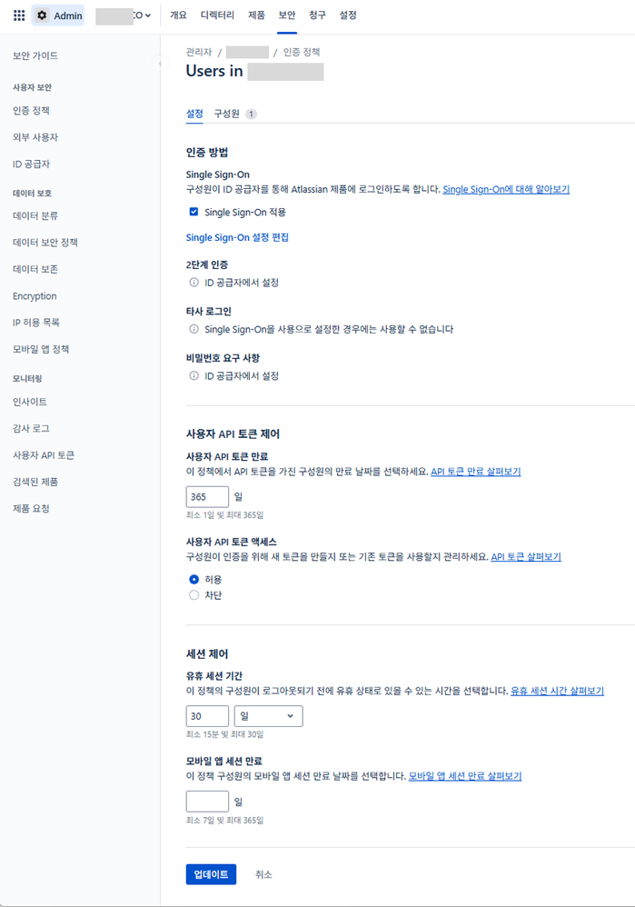

But please excuse that I have to show the configuration screen in Korean. On the Authentication Policy tab, the only policy-editing screen I see is the one attached. I can't find any idp-initiated options et cetera.
Our current plan is Guard premium plan for 30 days free.
In our IdP-initiated flow, we are redirected to Atlassian, but—as noted previously—the browser does not auto-login and instead shows:

Is there no option in the configuration to control enabling IdP initiated logins in the free Guard Premium 30-day trial version?
