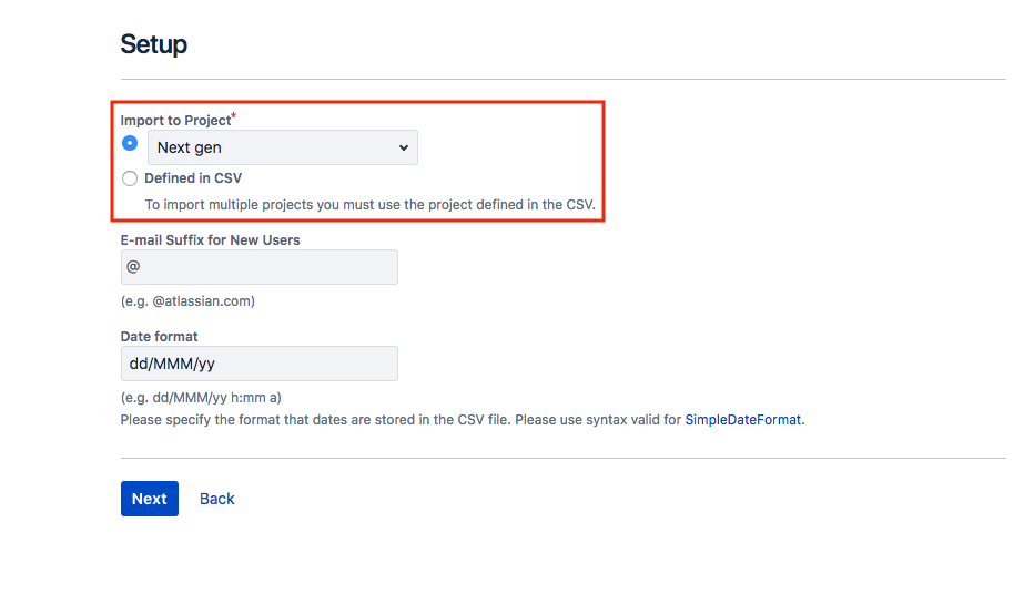

I found a screenshot in this bug report that suggests I should have an option to chose project type, but I did not have it in my import wizard. I could not find any other documentation on the matter.

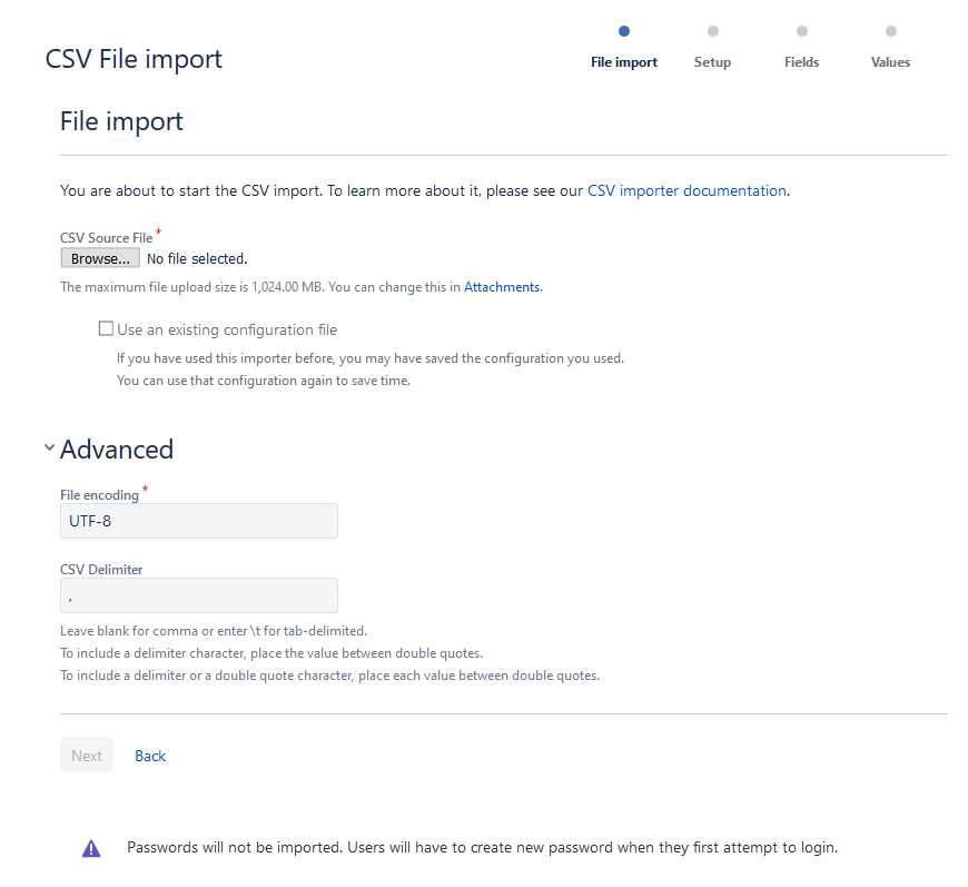

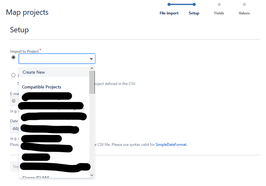

Edit: Here is what I see in step one and two of the Import process.
You can choose to import into an existing Next-Gen project - that's the drop-down you're seeing on the second screenshot. You can select the project in here.
This doesn't appear to work when you set the project in the CSV though - or try to create a new project via the CSV - as the project type is "software" - there is no "next-gen software"
There are a few anomalies in uploading to Next-Gen projects at the moment. An alternative is to upload to a classic project first then bulk move the issues into Next-Gen. See this page for migrating between Classic and Next-Gen projects.

Thank you, Stephen. That's what I will try to do as a workaround - upload as classic and migrate to next-gen.
