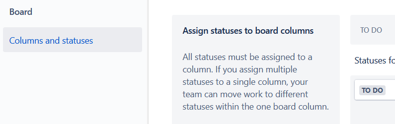

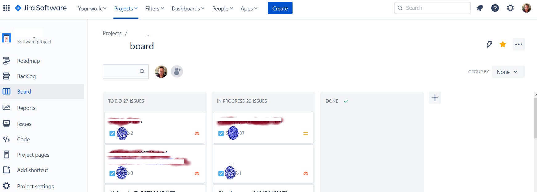

Thanks for the answers.. but this is what I get
There's my board .. click on the three ... and I get the configuration options shown in the second imageboard.png

I see the problem.  If you are in the board and go to Board Settings from the upper left, the Layout option is missing. The way to get there is do to the left hand nav (in the new nav format), click on the project, then under the project click on the three dots next to the board. That then opens the proper Board Settings menu with all the options, not the limited settings screen. This is a terrible UI failure that both ways to access the Board Settings don't result in a consistent experience.

Hi @Narendra Kumar - When I go to my Board settings, there's no Card Layout tab or option. I am using a Team-managed project in Jira cloud. What am I missing? Thanks.

Custom card layout is currently not available in team-managed projects in Jira Cloud. You can vote for it and track its progress here: https://jira.atlassian.com/browse/JSWCLOUD-17336
In the meantime, if your team needs it urgently, you can use Company-managed projects. Sorry for the inconvenience caused.
