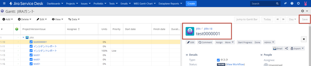

Hello Oscar,
Thank you for using WBS Gantt-Chart for Jira!
Did you click the save button?
You can edit multiple issues within the WBS Gantt-Chart view, and you have to click the save button to reflect the change.
If there are any changes, the save button is enabled.
After you click the save button and reflect the changes, the button becomes to be disabled.
Please confirm it to click the save button.

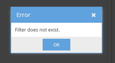

Yes I tried using the Save button, but it says "error" while saving. But later, I tried with a simplier Gantt and it worked. I don't really know why I had errors before... but thank you for your input, it helped!

Here is the error again, can you help to figure out what is the issue?
Could you confirm customfield_10014?
You can access customfield_10014 with link below.
https://<your site address>/secure/admin/ConfigureCustomField!default.jspa?customFieldId=10014
Please send the screenshot of it.
Also, please confirm that customfield_10014 is placed on issue edit or view screen.
