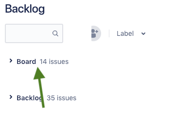

I have dozens of issues in my next-gen project in the backlog. The backlog has two regions "Backlog" and "Board". The issues in the "Board" region show in the TO DO column on the main board view. The issues in the Backlog region do not show on the main board view.
I am using an issue filter to sort my issues in the backlog in a particular order, and wish to do a bulk change of the issues from "Backlog" region to "Board" region. Is there a way to do this? What about a bulk change from "Board" to "Backlog". See image below...
An example filter would be to sort by due date and then do a bulk move of all issues with a due date in the next month from Backlog to Board.
project = JNEXTGEN AND status = "To Do" ORDER BY duedate ASC, updatedDate DESC

To recap: You want to move many issues from Backlog/ To do --> Board/ To do:
  1. Bulk change - Edit Issues will not work, because status is not an editable field.
  2. Bulk change - Operation Details will not work because "To do" status is in both board and backlog workflows
Have we tried a multi-select and drag from backlog to board?
Could add a transition status between "to do"/ backlog and board to differentiate. ie "to do"/ backlog v "sprint ready"/ board
  • Use Project settings/ workflows and board settings/ column management to make option #2 feasible.
Like • Heather Kendall likes this
James MacEwan
January 10, 2019
Multi-select Drag and drop would work if I could see the values of the fields that I am sorting by in the Backlog. Bonus would be if I could sort the Backlog by my filter AND see those values too, then the multi-select will be easy because all the issues I want will be beside each other in the board listing.
Option #2 it is, I will add a column before TO DO on the next-gen board and do my bulk moves from backlog to it. An implication is that I will not be using the "Board" feature in the backlog.
Thanks for the suggestions, they are much appreciated

I found a roundabout way to do this. If you go into your project settings and under Features, turn off backlog, it will move all items to the board. You can then turn backlog back on and it will ask if you want to move items back and say no. Not the most straight forward but it did work to get my 50+ items off the backlog and into To Do on my board

I found a roundabout way to do this. If you go into your project settings and under Features, turn off backlog, it will move all items to the board. You can then turn backlog back on and it will ask if you want to move items back and say no. Not the most straight forward but it did work to get my 50+ items off the backlog and into To Do on my boardbacklog.JPG
