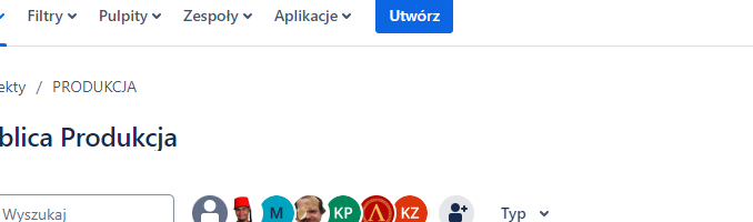

Hi! I have several boards in Jira but one is not working. If I add a new order using the blue button at the top, the order is "invisible".

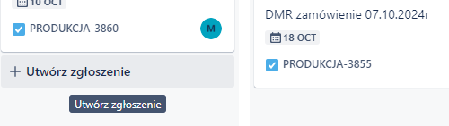

Nobody sees him. I have to add an order by scrolling down and at the end of the table "add order".
Do you know how to fix this error?

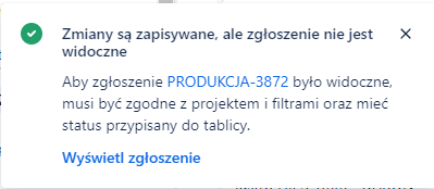

edit 1:
After adding a request using the blue button, it receives the message “In order for the notification to be visible, it must be in accordance with the project and filrt and have a status assigned to the board.”
And unfortunately, it is not visible. It appears in “notifications”

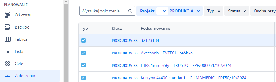

So the issue you are creating in a task in project PRODUKCJA
It is visible in the issue view, when filtering on the project.

Hi, thank you for your reply. I apologize in advance for errors but I am assisted by google translate. I get a notification like this (translated from Polish):
