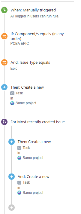

I have a manual automation
I create an EPIC: TEST123
then run my manual automation, this then should create 3 tasks
Then: create a new: TASK "Task 1 Create your project"
For most recently created issue
    then create a new: TASK "Task 2 create your part numbers"
    and: create a new: TASK "Task 3 create your bill of materials"
This works. I now want my tasks to be linked.
Task 2 create your part numbers (LINK TO TASK 1)
    Task 3 create your bill of materials (LINK TO TASK 1)

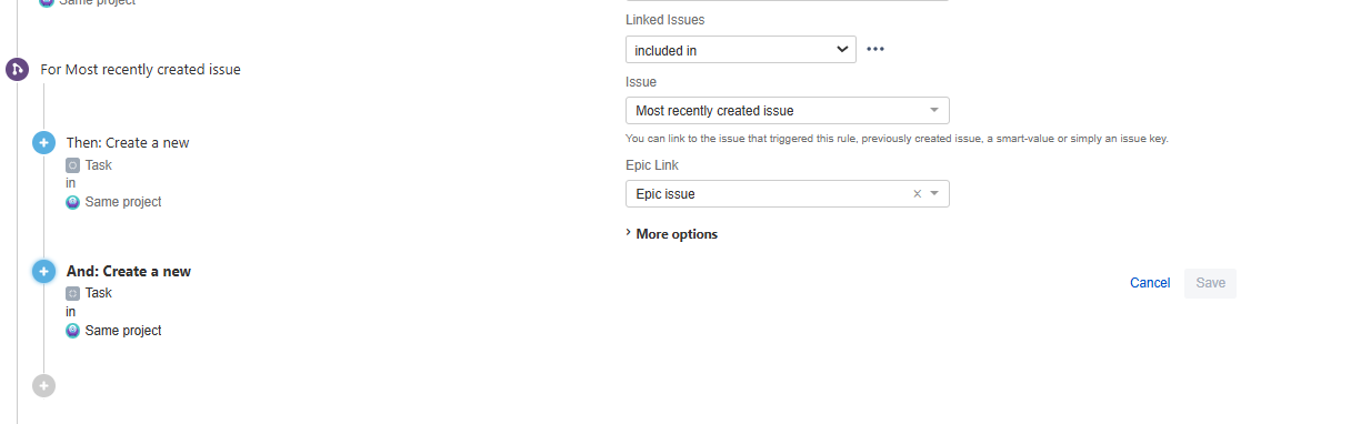

This is where the problem occurs. Instead I get:
        Task 3 create your bill of materials (LINK TO TASK 2)
Even though Task 3 is still under the "For most recently created issue" it should create a link to TASK 1. I cannot get it to work
Hi Julia,
When you link the issues to "Most recently created issue", that is relative to the last issue created.
As you are branching to the first one, Task 1, you could change the link to "Current Issue" as that will refer to the "branched to" issue.

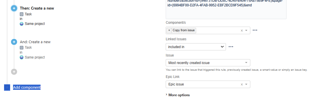

For Task 2 I have "most recently created issue" and this correctly links me to Task 1
But I cannot figure out any setting that will link Task 3 to Task 1. I am wondering if in Task 1 I need to save its issue key to a variable, and then in Task 3 assign the link to the variable I created...but I have no idea how to do that or if that is even correct
I only have these 2 options for what my issue is linking to:

So is the trigger issue an Epic? If so that may simplify things a bit:
Regarding "brittle"...In my opinion, any rule this long (i.e., around 35 steps) which relies on a person to correctly select the indices in the get() could be difficult to maintain. There are other ways to do this, although not necessarily better, such as using multiple rules and custom fields to determine the linking.
One benefit of having everything in one rule is making it easier to see / correct problems when they happen.
