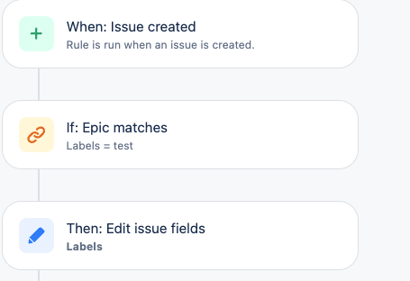

Hi ,
I am trying to set up an automation rule that gets triggered whenever an issue is created. If the epic that the issue is created in has the label "test", I want the issue to also receive the label "test" (I do not want to copy the other labels)
While this didn't seem complicated to set up, it's unfortunately not working for me.

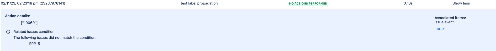

I checked the JQL query when setting up the rule and it found the epic with the label "test". However, the label did not  get propagated when I created a task within the epic. In the rule audit log, I can see that the "issue did not match the condition ". It looks like
I already tried setting the JQL query to "parent", this did not change the performance
Any idea what I could do ? Any help is highly appreciated!
Screenshot 2023-11-02 at 14.24.00.pngScreenshot 2023-11-02 at 14.24.57.pngScreenshot 2023-11-02 at 14.24.27.png

I keep seeing in the log that the issue did not match the condition; but the issue number is the number of the created issue and not the associated epic (Jira should be looking for the label in the epic not in the issue)

In my case, in the audit log I do not see the issue key from the epic, I only see the issue that triggered it (created issue) and was subsequently updated:

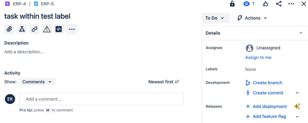

Yes, the scope is equivalent to the project I am triggering from. I think I finally figured out  (somehow ) what the issue was. When I created a task within an epic by clicking "create child issue", the task was created but Jira only sets the parent field miliseconds afterwards (I did not change the parent fieldmanually, this must have been triggered by Jira in the background).
But my rule got triggered upon issue creation with an empty parent field. I modified the rule now in the following way and it seems to work.
