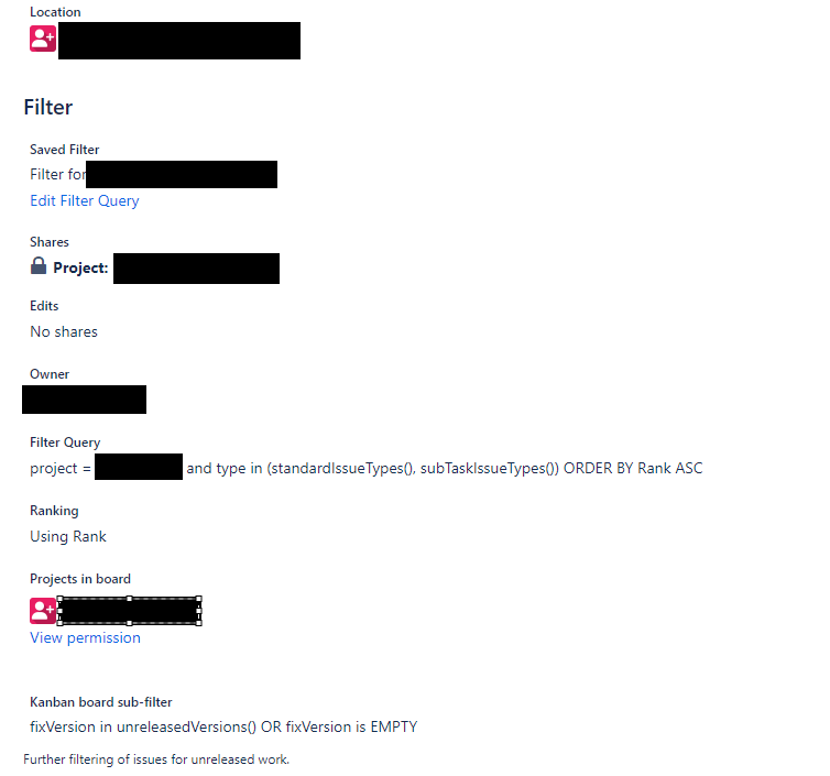

I've changed to filter to just "project = PARTNERON ORDER BY Rank ASC" and I'm still getting the error message. I've included a screenshot of the error message I get and the ticket. The 'to do' status is mapped to my backlog in the kanban board, but that is showing as empty when I view it. The same happens if I move the epic to either of the other two statuses

Thanks Rebekka - it was a sub-filter issue that has now been resolved, the official Atlassian Support were able to help so thank you for your pointer

You filter filters for "Standard Issue Types" and "Subtask Issue types". Per Default, an "Epic" is neither.
You can check that under Administration > Issues > Issue type hierarchy.
Assuming you've not changed the default configuration, your board won't show any Epics, as they aren't standard nor Subtask. You'll have to remove the and-clause (type in xxx).

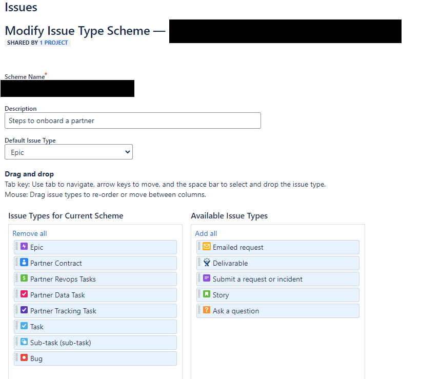

I haven't changed the issue type hierarchy, this is what shows for that (see image). I've remove the and-clause and that still doesn't show the epics on the board.
