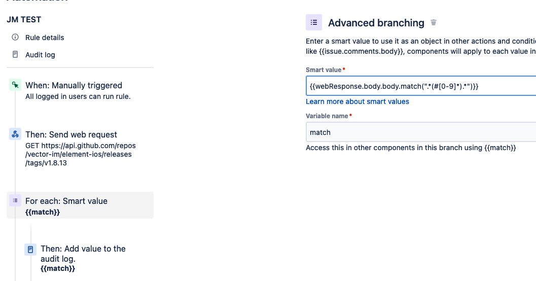

I have an automation rule in which I:
The problem is the "for each: smart value" branching doesn't actually iterate over the matches but instead treats the result of `match` as a single value.
Does anyone know how I could loop over the matches one by one?
As mentioned in my reply above, the audit log smartly collapses log messages which creates the impression that the whole list is a single string. It is, in fact, not though which means you can use operate on the element inside the branch exactly like you'd expect.

Hi @johannesm
I find that advanced branching occasionally needs "help"; sometimes it parses the source as a list and sometimes not. Two approaches for your source list are:
{{varMyBranchSource.split(",")}}{{#webResponse.body.body.match(".*(#[0-9]*).*")}}{{.}}{{/}}And also...I highly encourage you to always make variable names (created or branch) different from all possible reserved words. In your advanced branch you call it match and I would suggest always prefixing, such as varMatch.

First of all, thanks for pointing out that creating a variable forces to text. I was not aware and that explains some failures I saw while testing other things.
I tried both your suggestions but the behavior wasn't any different. One thing I did notice during testing though is that the audit log appears to smartly collapse log messages.
When I used
>{{varMatch}}<I noticed the angular brackets being added to each element in the output.
So ultimately, the audit log just makes it seem as if the value is a single string by collapsing the log messages into a single line.
Which means it worked correctly from the start and I just didn't realize because the log output kept me from trying to proceed. 🤦♂️
We've all been there.. I confess I missed it completely, too.
Regardless, I'm glad to hear it's working!

Thanks for your help Filipi!
It seems like the output of calling `match` is a list because calling `first` on it gives the first element.
However, inside the for each branching I appear to get the whole list as a single string and calling `first` there does nothing.
