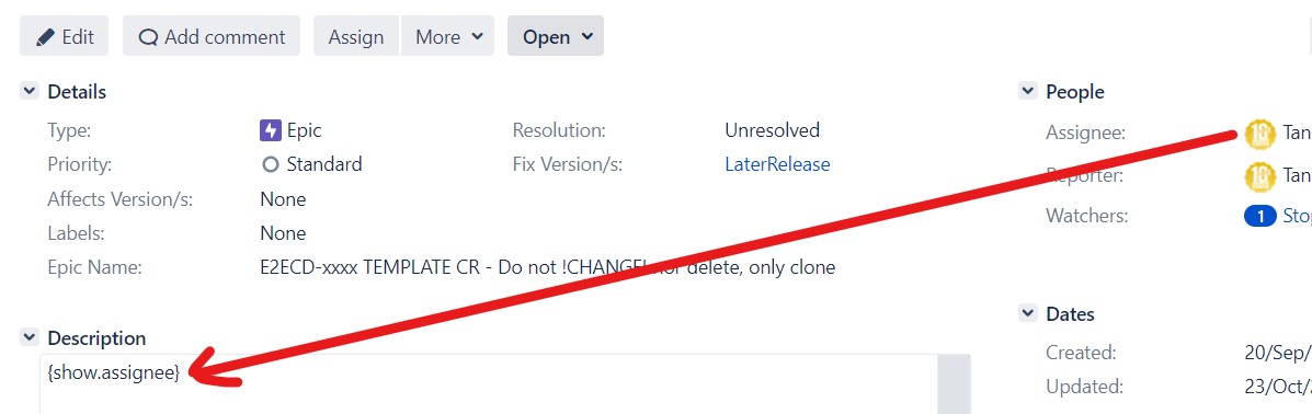

I would like to use the actual assignee in the description field of an epic like this:
unfortunately {show.assignee} does not work. ;) Is this somehow possible?
As background of the question: I would like to use this in a template. and then i'd like to print just the field 'description'.

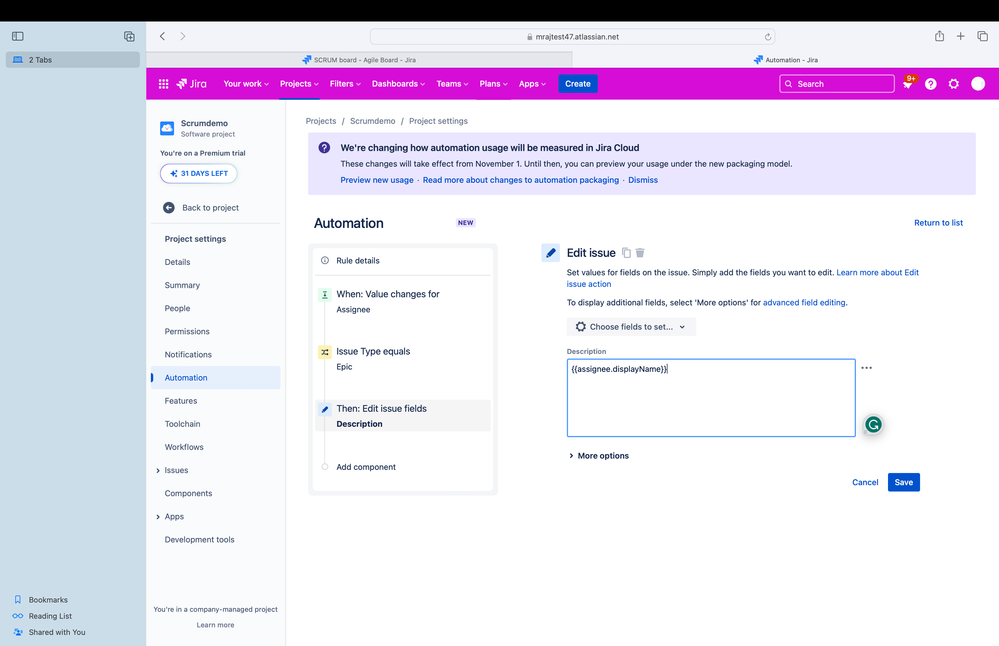

Hello, Good day. Please check if you could create an automation rule to edit the Epic issue type with following smart value.
{{assignee.displayName}}

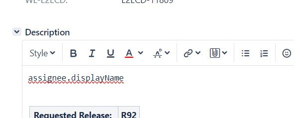

Stefan Tanner October 23, 2023
unfortunately this does not work. still this is shown and not the assignee's nameScreenshot 2023-10-24 085534.jpg
