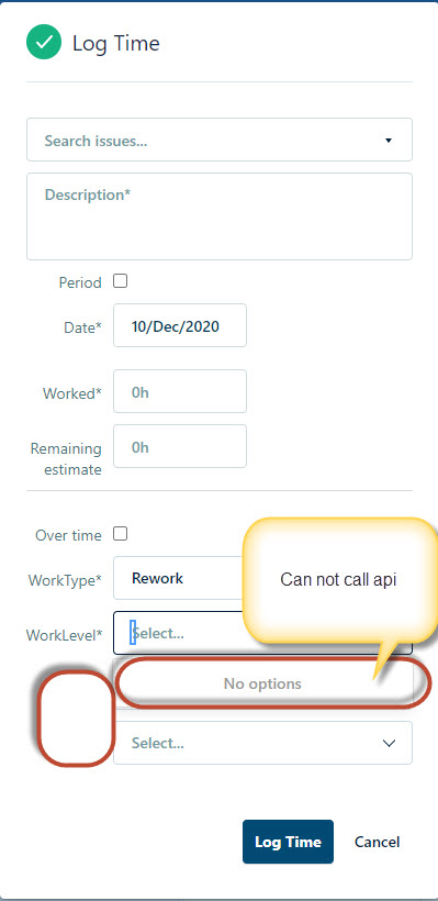

after that i'm trying :) logwork
When i selected 'WorkType' list box, nothing happened, it look like no API called :)
I have two question
1. Why tempo can not call API?, my configuration is incorrect?

Hi Alex
Thanks for your support
After i corrected some mistake, it worked :), i can create cascading worklog attributes
but i got other issue
i have 2 listbox
i got issue when
Regards

Hi Alex
Here my Tempo Timesheets version
I resend a video to clarify the problem I'm having with tempo 'Cascading dynamic workattributes'
Regards
Hi @An Phạm ,
can I ask you to downgrade to our offical version of Tempo 10.18.6 or at least test your setup against this version?
Maybe the best you submit a support ticket.
