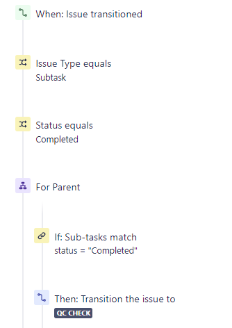

Parent rule (working)

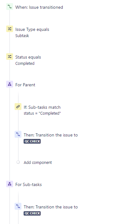

Dual rule attempt (only parent move is working)

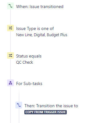

Separate rule for subtasks (not working)
Allie Biasci February 9, 2023
For anyone having this issue, here is the working rule (all in one):

This is the subtask rule. The parent issues are stories if that matters.
