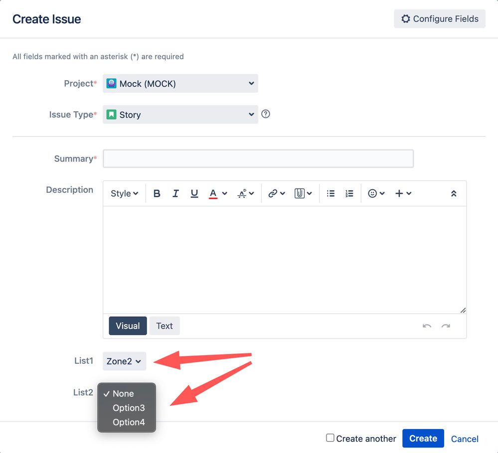

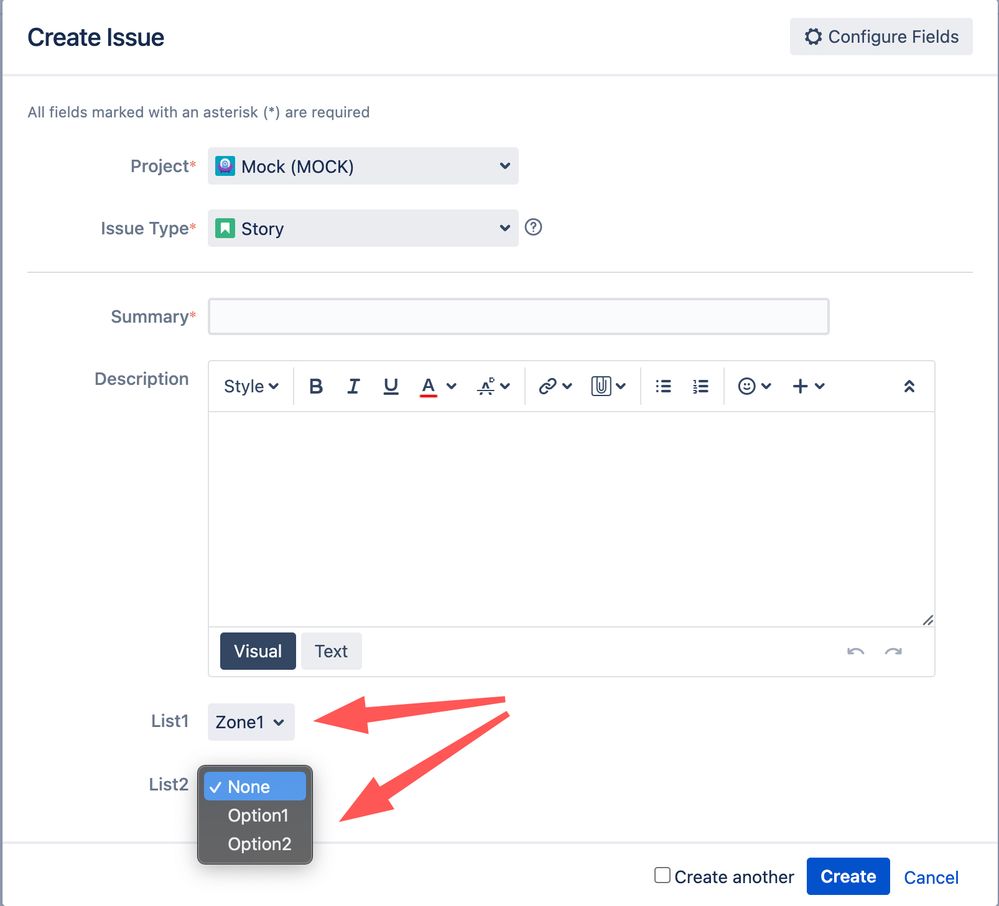

Also, you don't need to create a separate if/else condition for the None option.
Just set the default list options before the if/else condition. If none of the options is selected, the default options will be displayed in the second list.
Below are a couple of test screenshots for your reference:-
