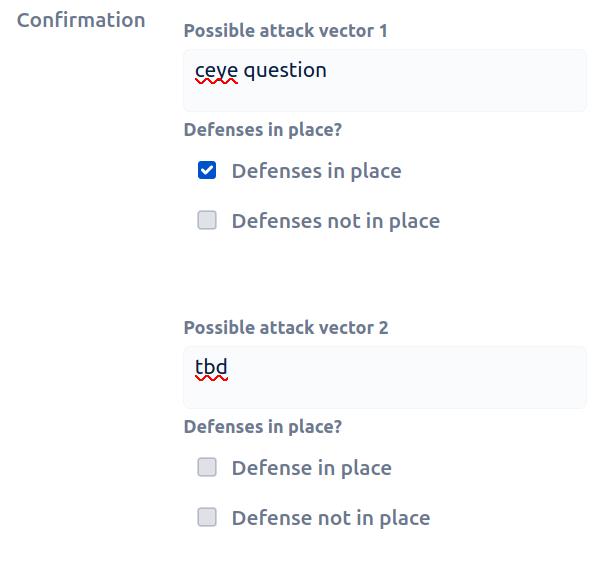

I am having a TextField and has a few other TextFields and checkboxes inside it. The main Field is named as Confirmation and the rest are the subfields. Here is a picture of the view
I want to get the values of all the subfields named. How do I do that? is there any way for this? If I use the id of the main field, I get a mess of JSON in response. I just want the name and field value of all the subfields/ Is there any possible solution for that? thanks a lot.

This field is not a standard Jira field, it is almost certainly a field type provided by a plugin.
It is pretending to be a text field as far as Jira's data is concerned, and then it is encoding data in Json and interpreting it as a set of fields when Jira calls its code to draw the field.
When your code is asking the field for its content, Jira is responding with the actual content - a block of Json that you're going to need to read and understand in the context of the app that is providing the field.
I would check if the app has an alternate way of reading its data out of a field, but if it does not, then you're going to have to interpret the json yourself.

@Nic Brough -Adaptavist-  I have got to deal with the issue. deviniti was used for this designing. Thanks for your support
Solution was available over this link. i just had to modify if according to my requirements.
