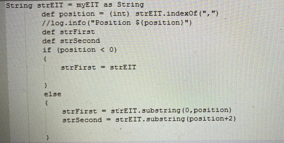

To give some info : The field values are being fetched into the jira database from another team’s database. In Jira the value is spit into a parent and child drop down and updated for the issue. Now we are planning on using a new custom field in Jira with a single drop down.
Example - In db table ,field value is stored as Option1,Option2
In Jira it’s split and updated as Option1 (Parent value) & Option2 (Child value) by the script job.
Below is a snippet of the old code (where the splitting happens) that populates the value into the cascading field for the Jira Epic issue type ONLY if it’s empty :)

As far as I understand, you will use parentOption (which is Option 1 in your DB) to update the drop-down and you will remove those childOption parts from the code.

Below is the updated code relevant to the one you already shared.
Assuming,
import com.atlassian.jira.component.ComponentAccessor
import com.atlassian.jira.issue.ModifiedValue
import com.atlassian.jira.issue.util.DefaultIssueChangeHolder
String strEIT = "value-from-db"
String strEC = "ABC-123"
def issue = ComponentAccessor.getIssueManager().getIssueByCurrentKey(strEC)
if (issue && issue.getIssueType().getName().equalsIgnoreCase("epic")) {
def customField = ComponentAccessor.getCustomFieldManager().getCustomFieldObject(12898)
def availableOptions = ComponentAccessor.optionsManager.getOptions(customField.getRelevantConfig(issue))
def optionToSet = availableOptions.find { it.toString() == strEIT }
customField.updateValue(null, issue, new ModifiedValue(issue.getCustomFieldValue(customField), optionToSet), new DefaultIssueChangeHolder())
I hope it helps, please let me know if you have further questions.
