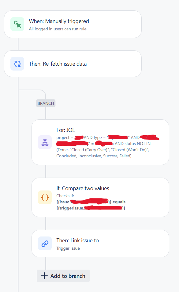

Hey everyone, I'm trying to make a manual trigger automation that links all issues that is linked to the trigger issue to a different list of issues if their values on a custom field is the same. To better illustrate this:
Automation:
So far I have managed to create an automation that can link Linked Issue 1 to Linked Issue 3 but it has to be triggered on the linked issue but not the main Issue with all the target linked issues. See the screenshot below:
Automation:
I'm hoping to add on to it so I do not have to manually go into each linked issue to trigger the automation but just have it trigger on the main issue all relevant issues are linked to. Is that possible to do?

is Issue 1 and Issue 2 Epic or standardIssueTypes?
Other than Custom Field 1, how are these related to each other for automation to determine linkage?
if there is no other way, have you tried the automation with Field Change on Custom Field 1?
Hey @Vishal Biyani Thanks for the response!
Issue 1 & 2 are Standard Issue Types!
I am using a different custom field in the JQL to determine the list to link to in the above automation but other than that, no other relations.
I have but that again was on a issue by issue basis, I was not able to make it so that it's linked issues in Issue 1 to linked issues in Issue 2.
