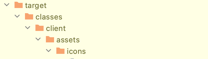

I can see that there's my assets folder in the target. So in terms of delivery to jira run task this seems fine:
Did I miss something or can give me someone any advice how to proceed here.
