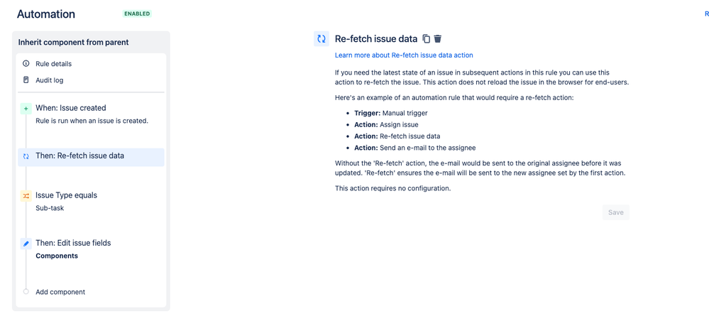

I have set up an automation rule but it doesn't seem to be working. When i tried to create sub-task, still needed to manually choose the component.

It is possible this is a timing issue.  The Issue Created trigger can fire so quickly the issue data is not available at the time the rule runs.  This can cause later rule steps to not work as expected; for example, perhaps the parent is not visible / set yet for the copy of Components.
The work-around for this is to always add the Re-fetch Issue action immediately after the Issue Created trigger.  This will slow down the rule by about a second and reload the issue data before proceeding.
Please try that to see how it impacts the results.

Thanks Bill, added a re-fetch issue action but unfortunately it is still working.

Please move the Re-fetch up to immediately after the trigger, and then re-test:
  • trigger: issue created
  • action: re-fetch issue
  • condition: issue type equals Sub-task
  • action: edit issue fields for Components

Thanks again Bill, tried as you suggested, still not working.
