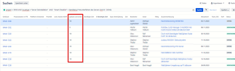

Incorrect JQL result
Hello all,
Our jql filter doesn't always work, but when it does at least it shows the correct data:))
To make it work, I always have to reindex the project or do a complete Jira reindex. But these approaches don't always help. Sometimes I still don't get an issue with the filter.
I have identified that it concerns the "goback-connector" field. Does anyone know why?
This is a completely normal number field.
project = SRVB AND issuetype ="Server Deinstallation" AND goback-connector = 10 AND "Smart Checklist" = itemStatus("Herunterfahren des Servers (init 0)", DONE)

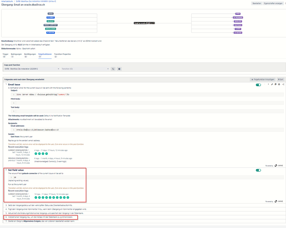

The cause is may be a storage problem but this is a JMWE transition and an issue update is done in issue history (5) also issue is indexed after the change (6SRVB10.png

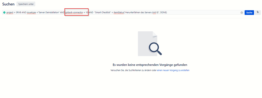

This is exactly the opposite. Only with Smart checklist part I see always issues.
The cause is "goback-connector". If I leave out the Smart checklist part, jira does not find any tickets with "goback-connector=10"
Of course after some reindexing, if i'm lucky i'll see the results of complete filters.

So as I can see on the reply from you on the option from @Radek Dostál
It is an indexing issue, in relation with JMWE and post-function order.
How does the setup look like in JMWE and the related workflow post-function, are you able to share screenshots?
Marc Koppelaar
Nov 15, 2023
Hi @Bektas Ozan Topkaya
You seem to have an old JMWE version running as I use the app as well, this post-function is noted as Obsolete!
You should use the Set issue fields function
OBSOLETE: use the more powerful 'Set issue fields (JMWE app)' post-function instead. Set the value of a field in the current issue or issue(s) related to the current issue.
