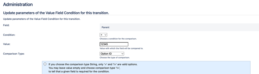

I'm struggling to get the workflow condition, value field, for the field parent working.
My purpose: I want to allow a workflow transition only if my issue has a specific parent.
I tried to set different Value Field conditions on my transition, but none worked.
  • Condition, comparison number
    • Field: Parent
    • Condition: =
    • Value: 12345
    • Type of comparison: Number
  • Condition, comparison string
    • Field: Parent
    • Condition: =
    • Value: XX-1234
    • Type of comparison: String
    • Field: Parent
    • Condition: =
    • Value: Summary Of My Parent
None of these conditions let my issue with parent 12345 transition to my status.
I guess I'm doing something wrong, but I can't see what.
Could you help me ?
Thanks in advance, have a nice day
Clément

@Clément FREDERIC might still be valuable to know that if you add multiple conditions with Option ID for each (include the parent and child value ID's individually) then select 'any of the conditions' seems to work for me. Might not be exactly what you originally wanted but seems there is no way to include parent and child values in one Condition.

Hi @Clément FREDERIC ,
You can use the Linked Issues Condition from JMWE app with the jira expression:
issue.parent.key == "XX-1234"
Hope this helps!

Hi @Reshma Begum {Appfire}  and thanks for your answer!
Indeed this is what I'm trying to achieve.
However should not this be working without app ? Unless I misunderstand the condition, value field for parent.
Anyway I will take a look at the plugin you mentioned.
