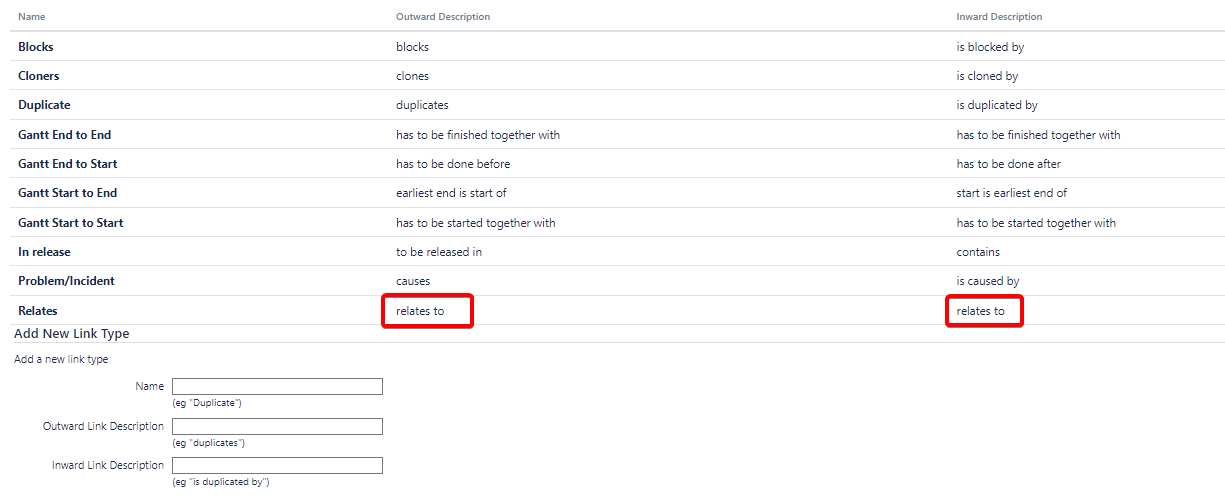

Dear all,
As you can see from below picture, the Relates issue linking config as same value for the Inward and outward description. This is default Jira value
The problem with that is we have already issue which used this type of Link but how to identify from any issue if the selected link is the outward or Inward because in link selection we have only a selected text of Relates to as seen in below picture

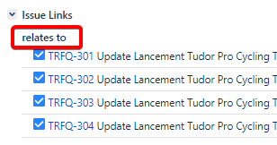

Parent issue Links :
Sample TRFQ-301 issue link to parent :
Which one of the links is Inward and Outward ?

Hi @Calderara Serge
Let me try to explain. If you are on issue A and you create a "relates to" link to issue B, Issue B becomes an inward link to issue A. If you switch over to viewing issue B, issue A is an outward link to issue B.
I think this is why the "relates to" is the same, as it only describe which issue started the linking relationship.
I hope this helps.

Hello @Garrett McCreery , I am still facing an issue.
As you mention the relates to system link entry in jira by default have same value for Inward or Outward link. But the name "Relates to" appears only once time in the list as it is same value for In and Out. So how to be sure we select the inward link and not the outward link ?
The reason for this is the follwoing context. I have an issue with related issue to it using Relates to as seen below. This is the Parent issue
As you can see, I have 2 references Issue Links using relates to.
